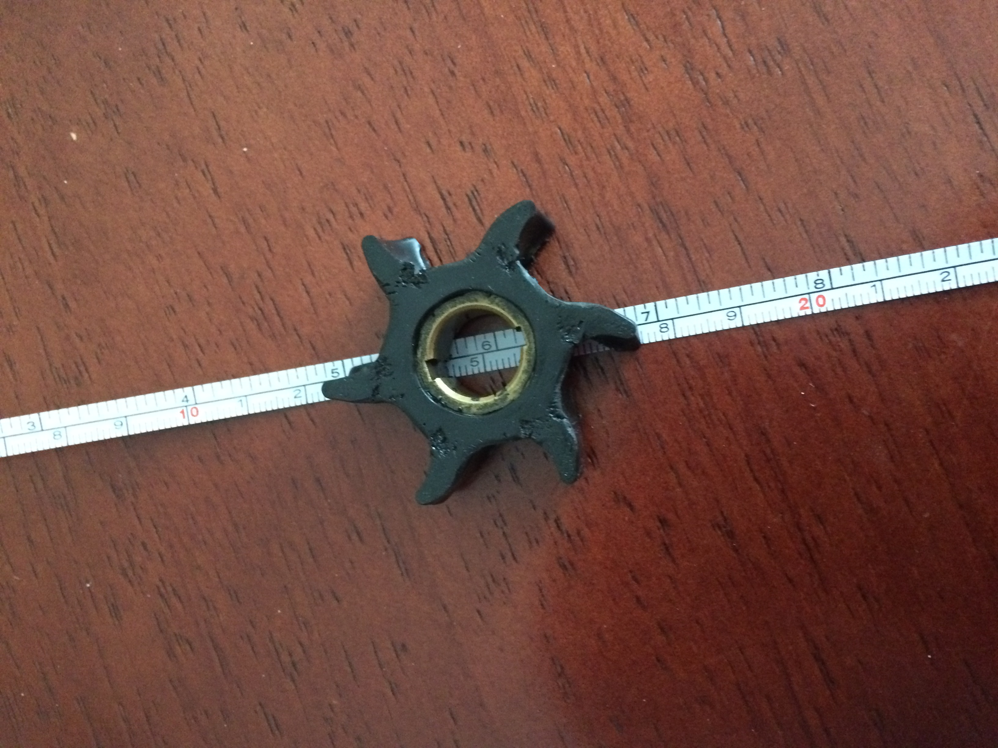

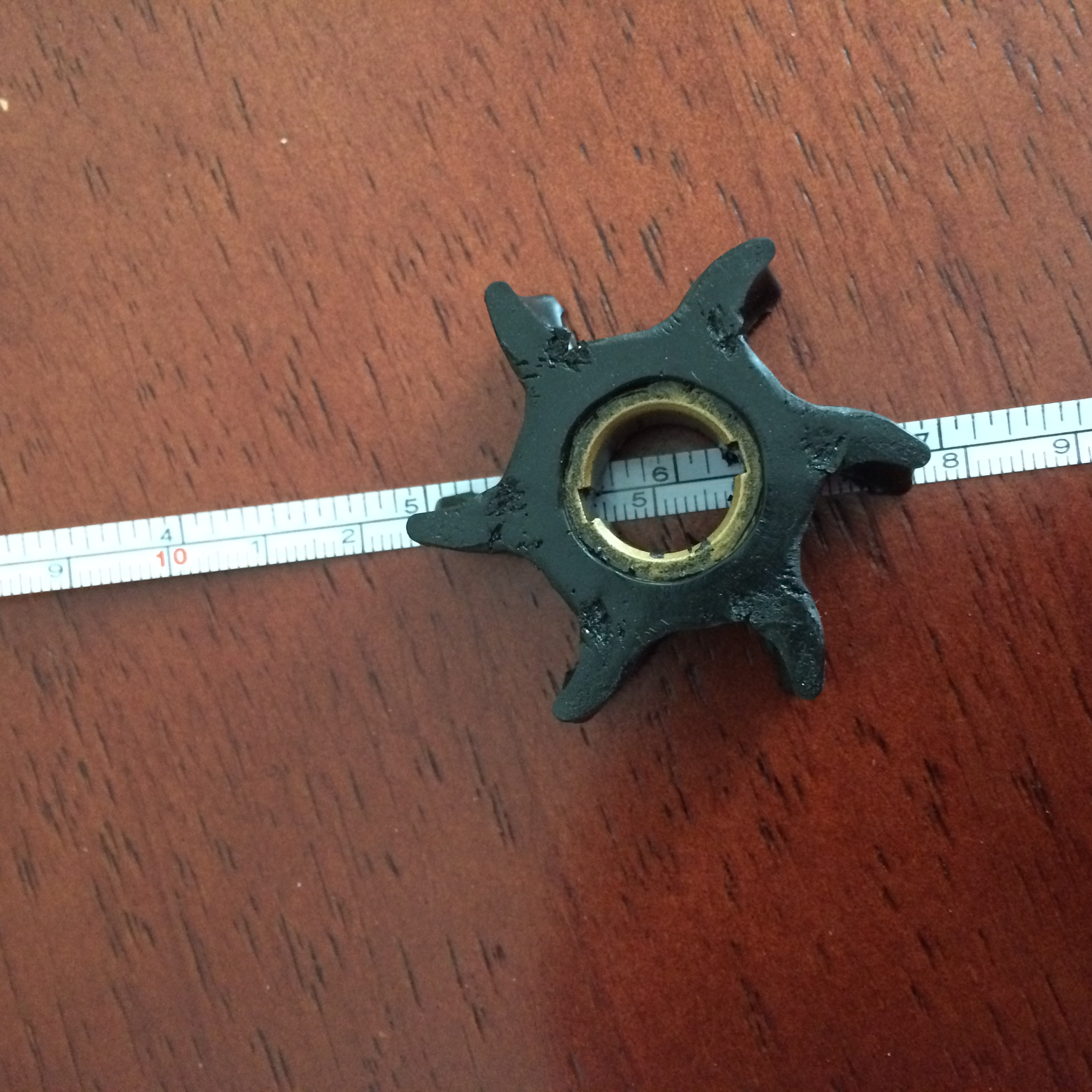

                  Here is the info
                  6 blade
                  ID 0.495 inches, 1.845 inches od, 0,567inches thickness

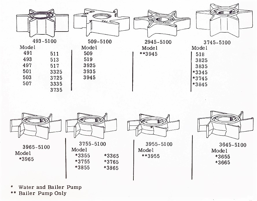

                      How many would you like to get? Lol Got the newer double blade (later model) of the model in stock. The rubber on these is like they were made yesterday and very supple. The # on the parts box: 3785-5100
                      #55753
                        That’s a good part number Jer! I did buy one with that P/N for my ’56 7.5 but it was the single blade style. If the imported ones don’t work for the bailer side, I’ll be calling you.
