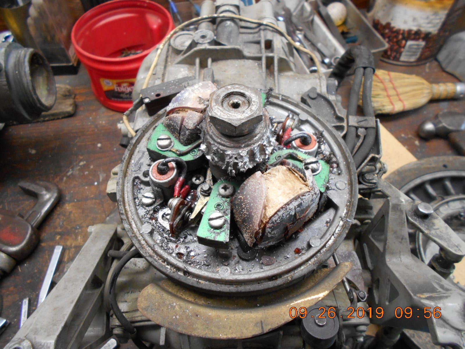

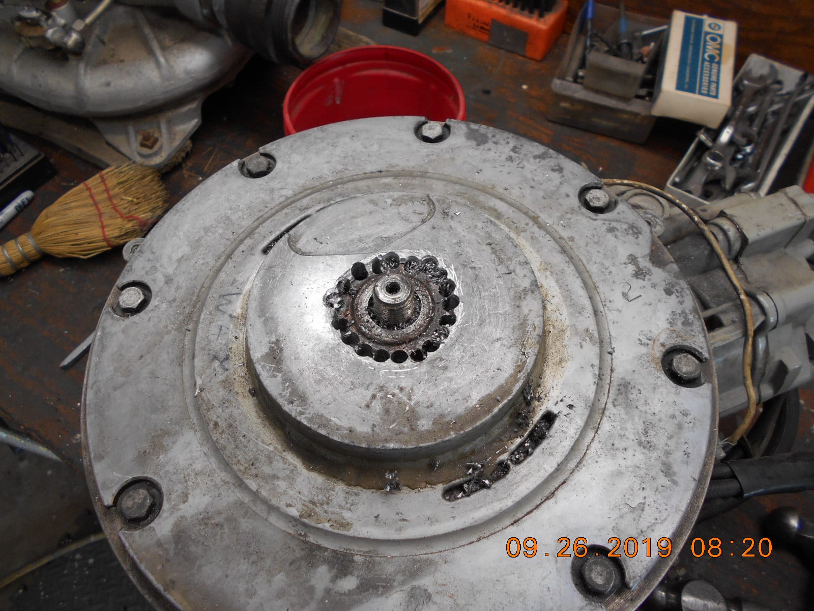

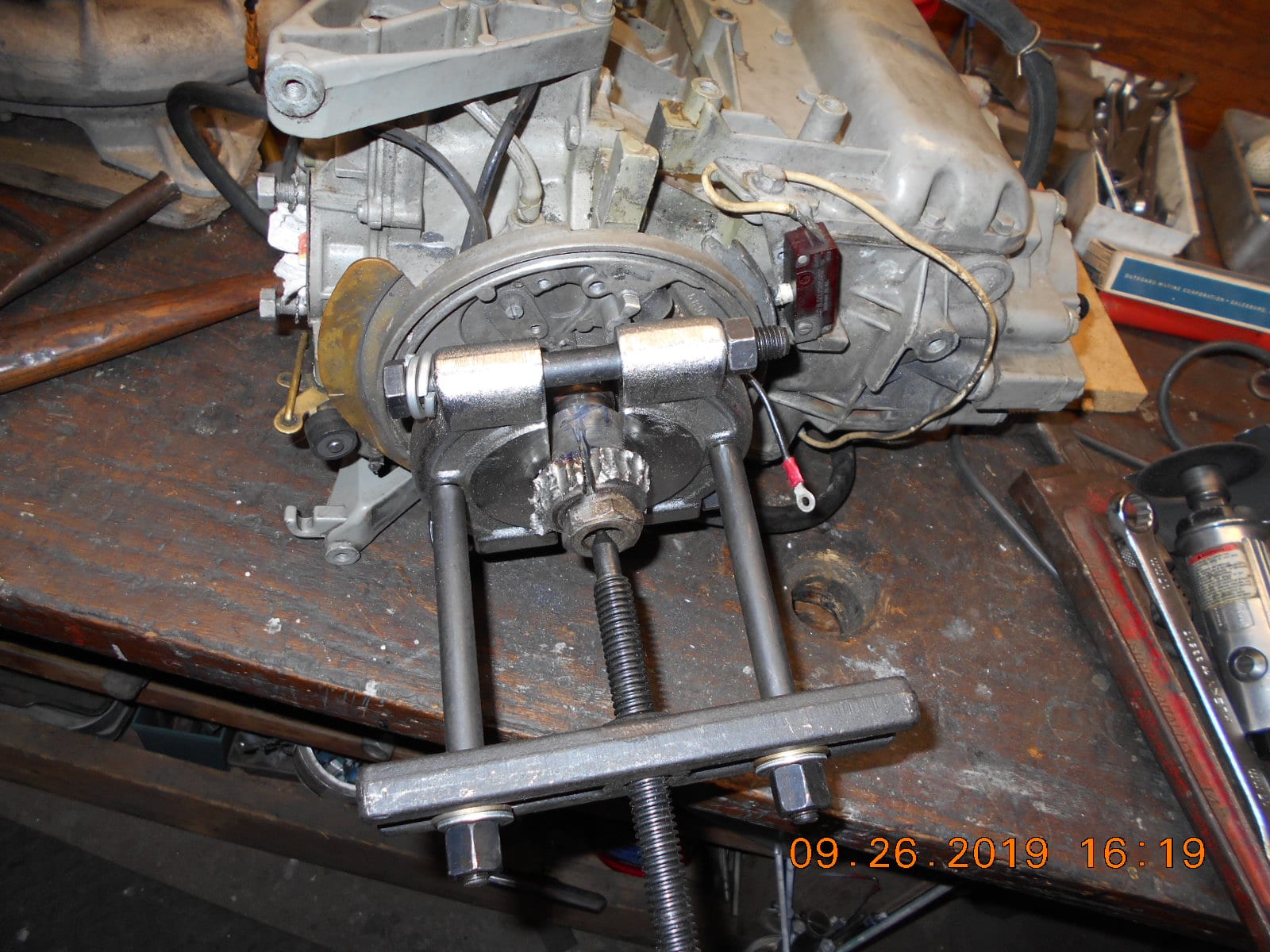

                I had the correct puller on my 1962 40 hp Gale, and when all else failed, this
                is how I got mine off.
                The flywheel key was “galled” bad, but I don’t know if that had anything to
                do with it not wanting to pop off.
                Hopefully yours comes off better!

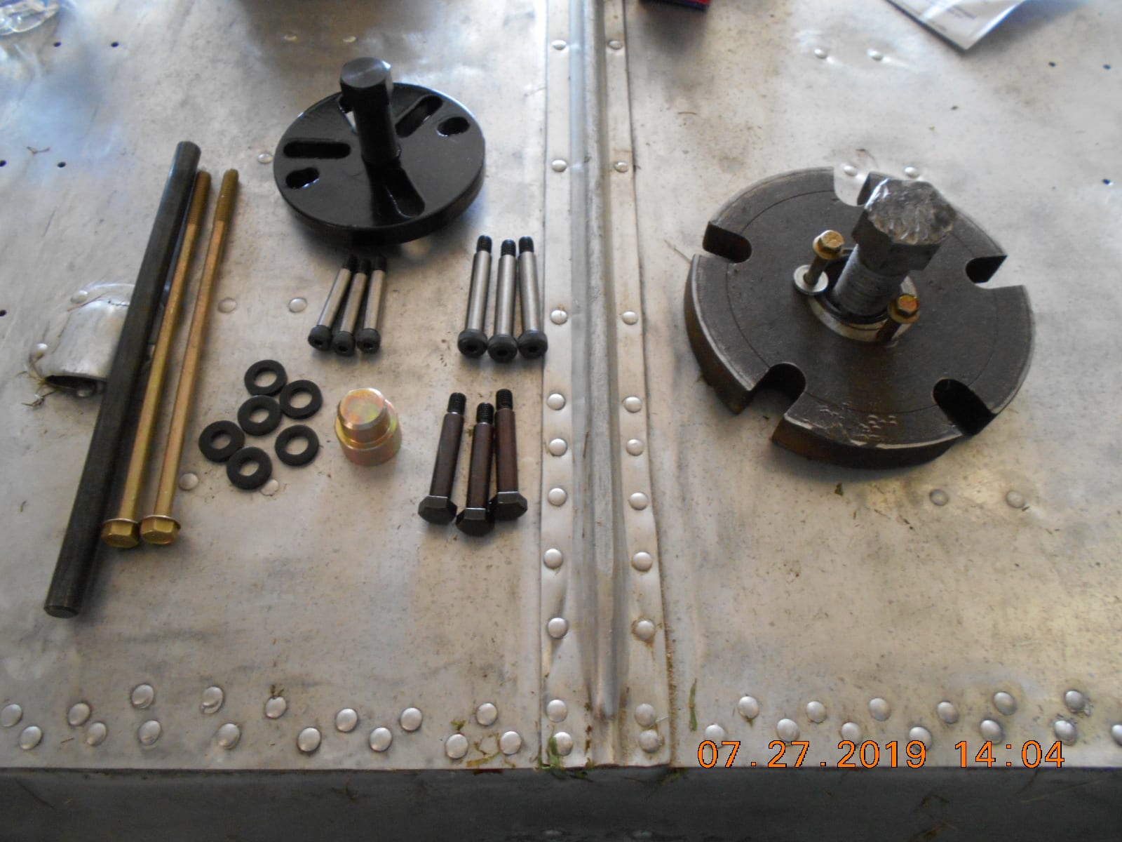

                  #235766
                  aquasonic
                    You will appreciate the “shoulder bolts”. You get the correct amount of bolt thread in the flywheel every time. Just turn them until they stop at the shoulder.
