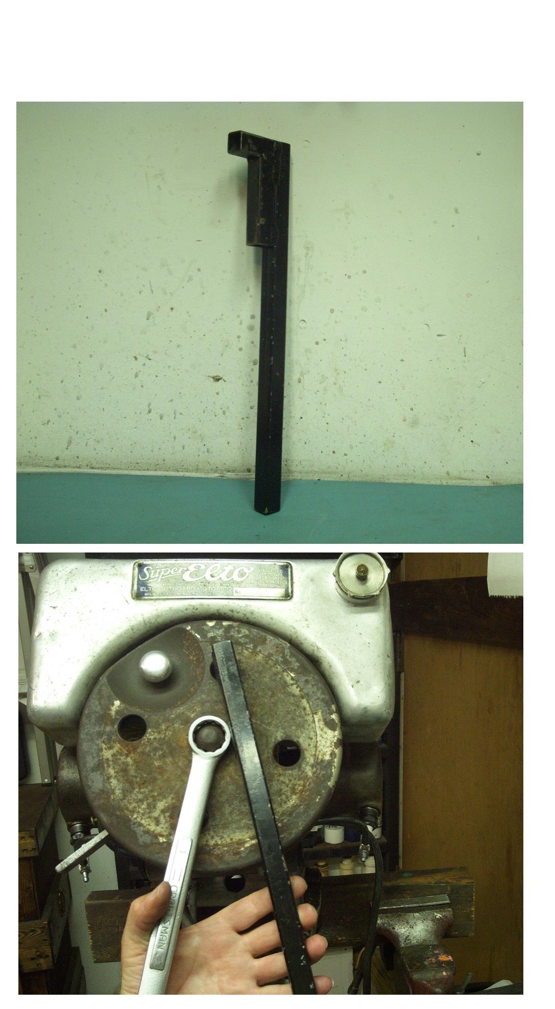

          #58859
            I made this tool for my Super Elto’s.
            #58861
            PugetSoundBoater
              quote Tubs:
              Tubs,I like that setup.

                    btw. I like Tubs way
