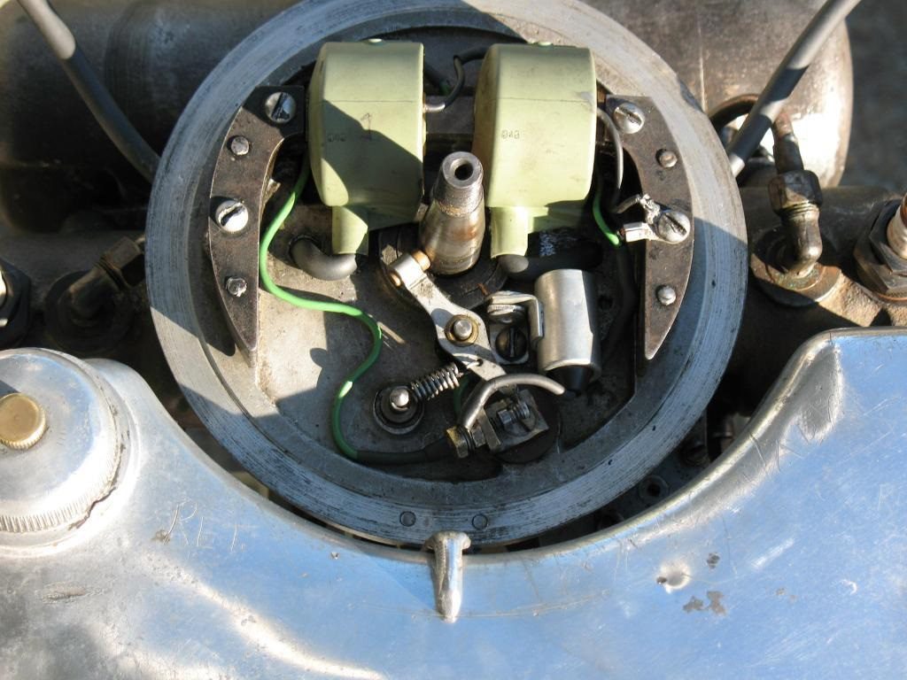

                Mine runs on the coil it came with. A member posted this picture of his OMC conversion. Military coil most likely can be used as well.
              Coil-Conversion-Fold-Light
              #302585
              Waunnaboat
                US Junior Member
                That note on the plug wires is good to know.  I’ve had one 1940 sportsman coil that was junk even with plenty of points cleaning and everything else, and it had absolutely no continuity from any point.  Hopefully these motors are all good once I have enough time to work on them.
