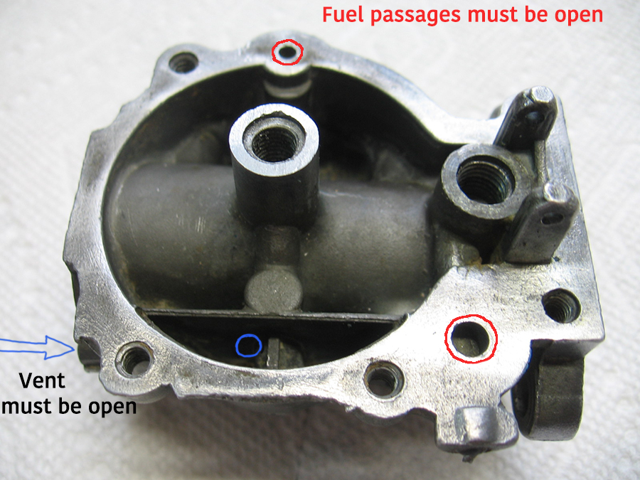

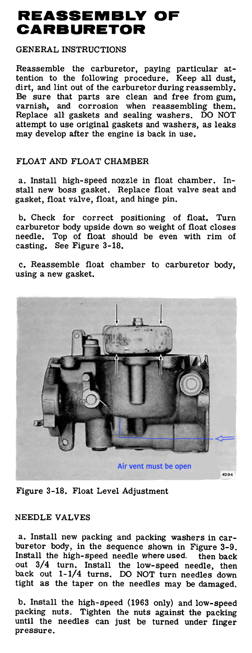

        There are just a few areas that give problems in most classic OMC carburetors . . . 🙂
        Bits of junk in the slots under the Welsh plug on the top of the carburetor will cause problems when coming off idle.
        #83784
          Drifter, you may have helped me. i have a CD-15 im trying to get going and it did the same thing. i havent gotten a chance to yank the carb off again and check the vents. Although a little odd as when it was apart to put the new kit in i blew all the holes out with compressed air, i did notice a mud dauber nest outside the carb in one of the crevasses so…. ill revisit this tomorrow.
          #83798
          drifter
            The engine runs great with the slightly smaller carb (0.750). It may be the easiest starting engine I have ever owned. I have tested it in the tank 3 different times and it starts in one pull from cold or hot. Idles very smoothly down to a tick/tock and appears to transition quickly and smoothly to as high a speed as I dare in the tank. I sure learned something yesterday and I am really happy to say so. I freed one side (left) with lots of air and brake cleaner, and the other side with a drill bit held in hand followed by air and cleaner.
            Thank you all,
