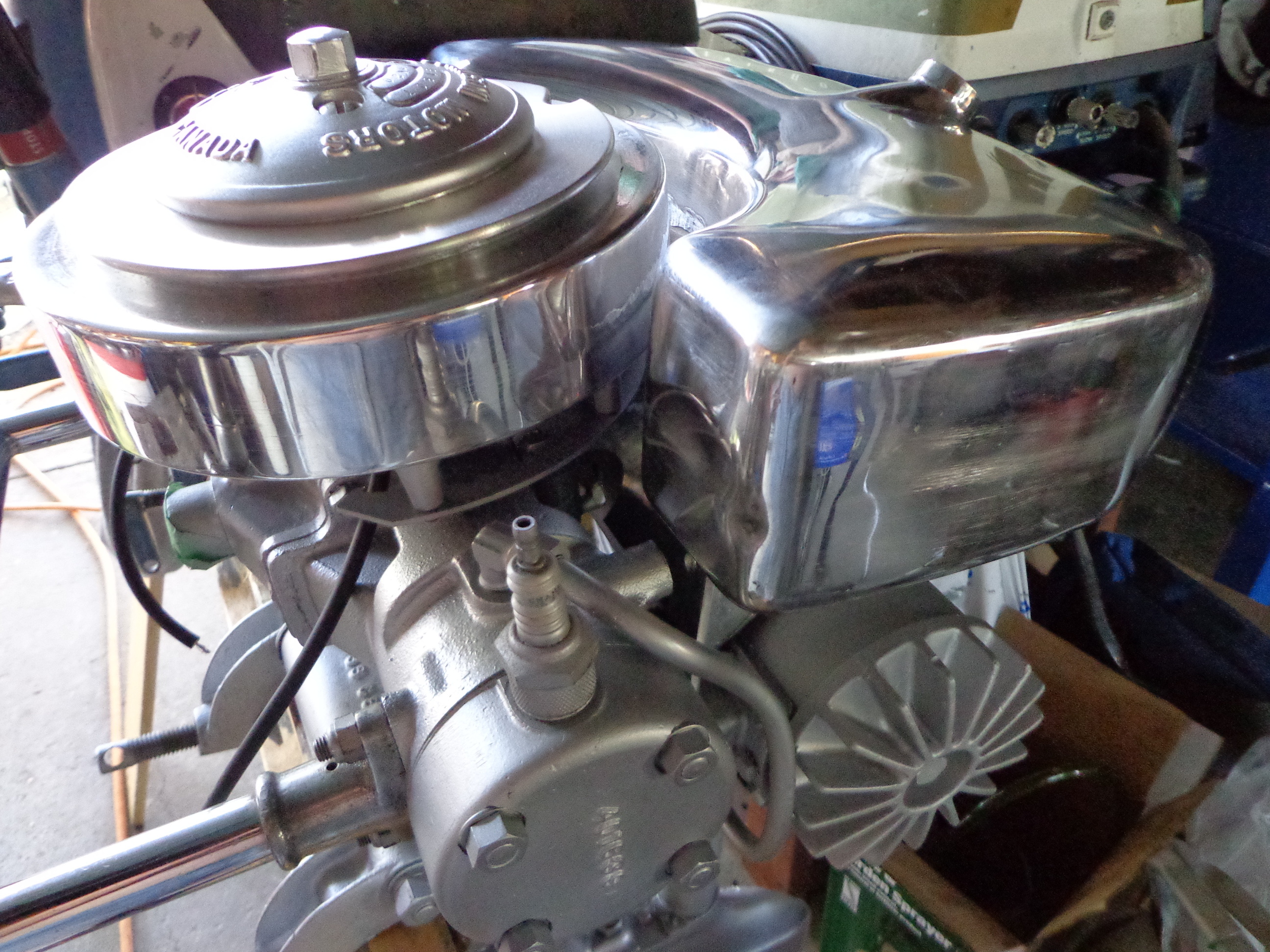

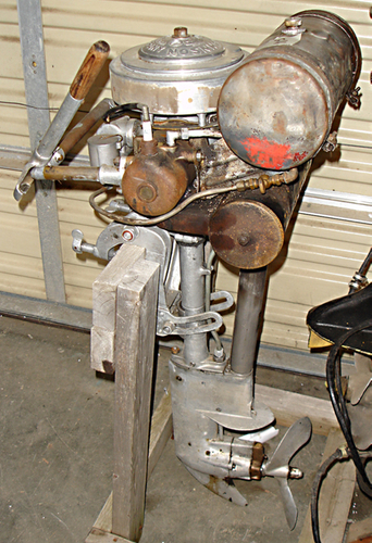

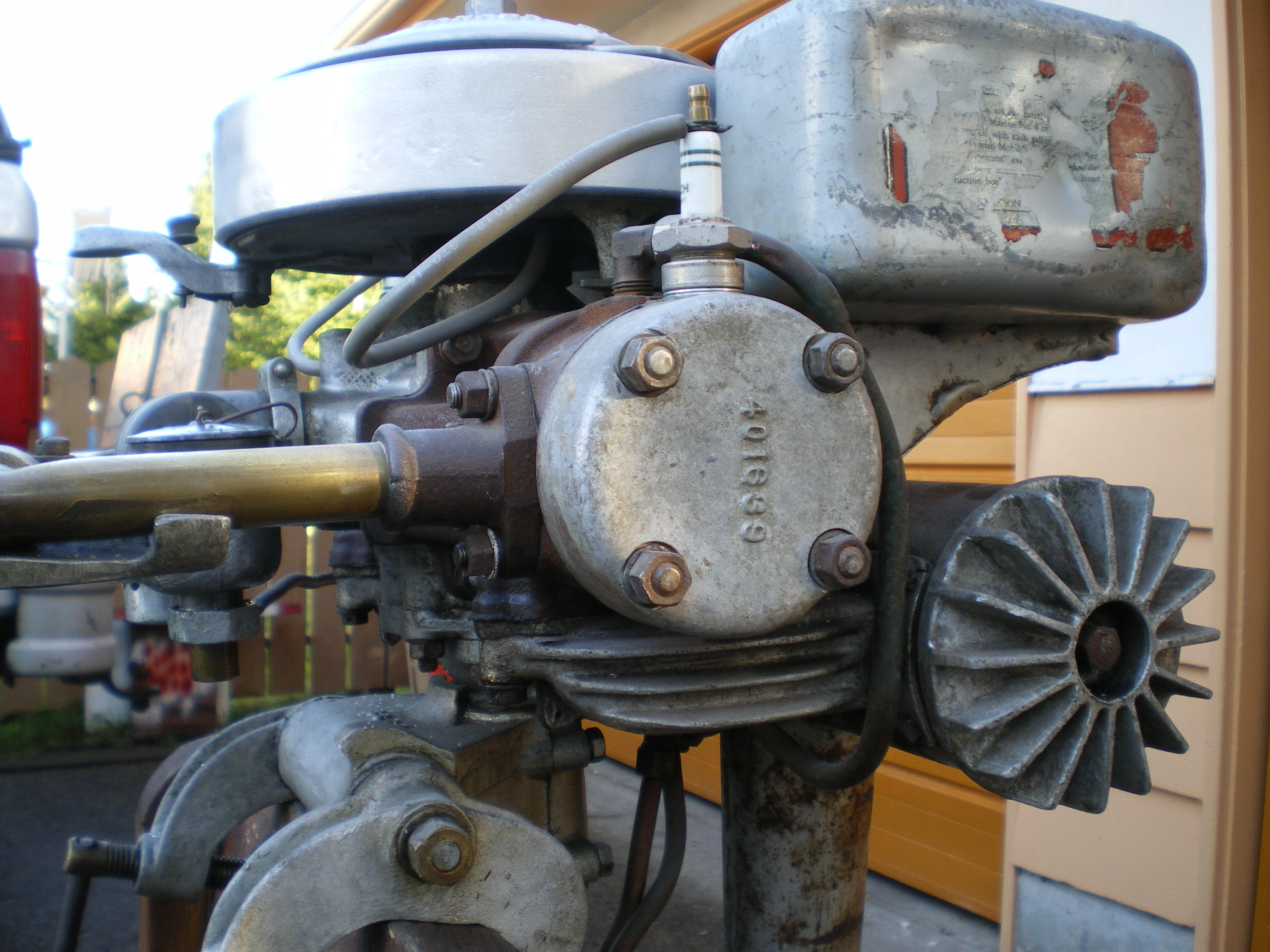

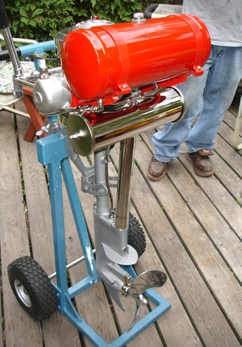

        Here’s some before and after pics of a OK 55 I found on the web.
