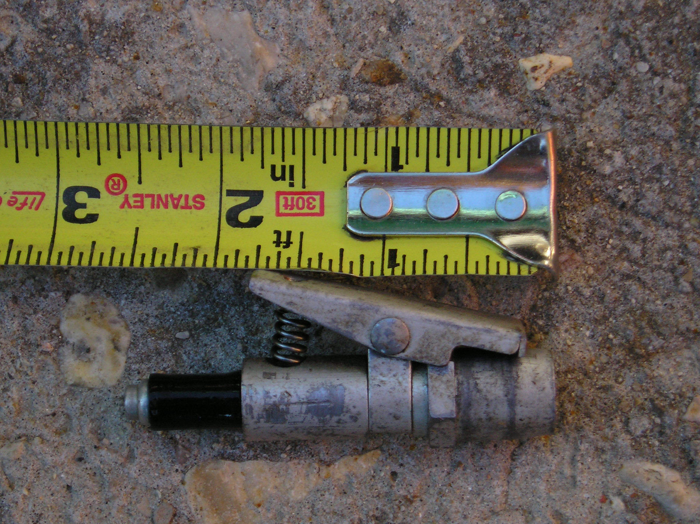

      Hay Steve, here is the requested picture of the Clinton fuel connector. It has a half inch O.D. and is two and a half inches long. I hope your daughter has good luck in finding one.

        Thanks for the picture. It will help in the search.

          On these clip connectors the "O" can be replaced for perfect sealing. Good luck hunting. Ed

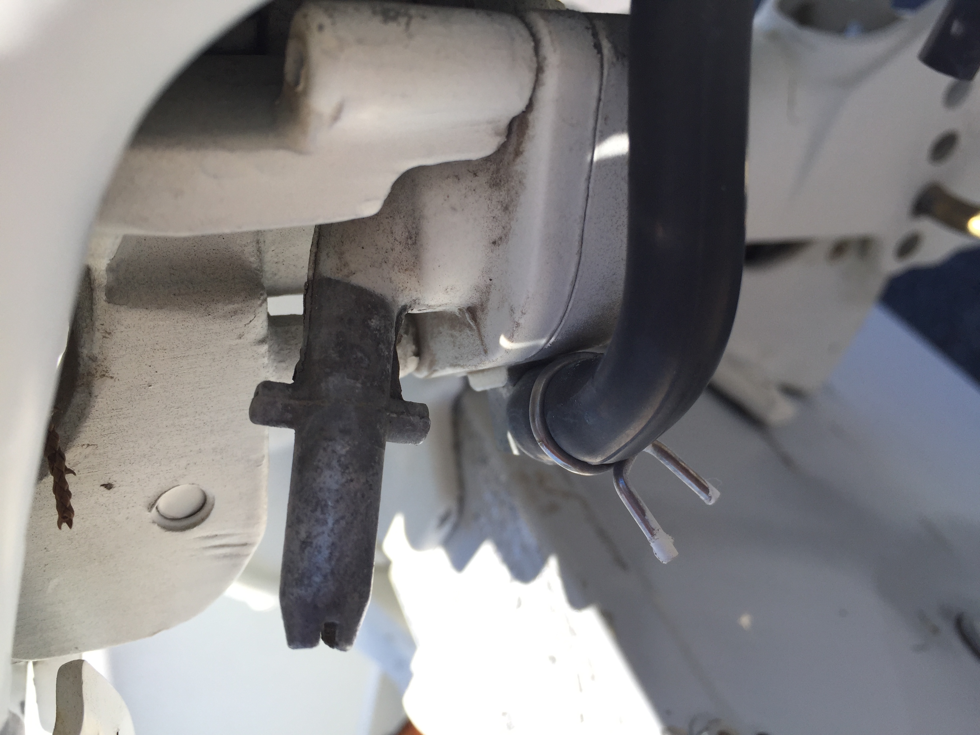

              Okay, so recently found out what my motor is and everyone has been a help so far.
              I’m stumped though, I got a primer bulb, some line, and a tank. But the connection to the motor is awkward… see my picture … where can I find the right "fitting" for this?…

                Looks like a McColloch 7.5. Takes a Scott or small Merc fitting. I got both

                  From the looks of the pitting, you might be better off fastening a short piece of hose to it with a common OMC connector attached and use easy to find OMC hose connectors. . . 😕

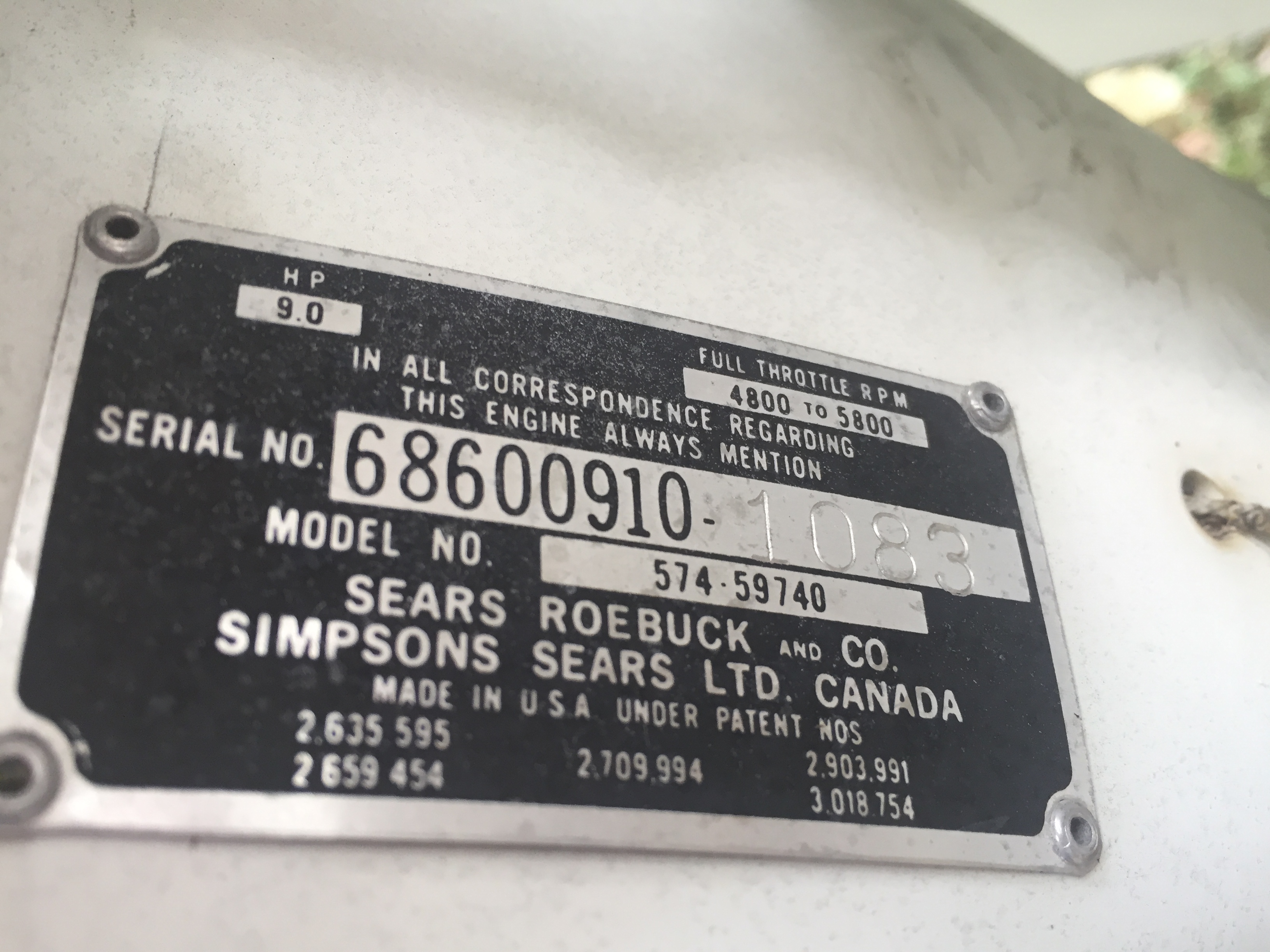

                    My motor is a McCullough, ted Williams sears see picture … can you fwd me a link for this fitting? Or am I buying it from you?
