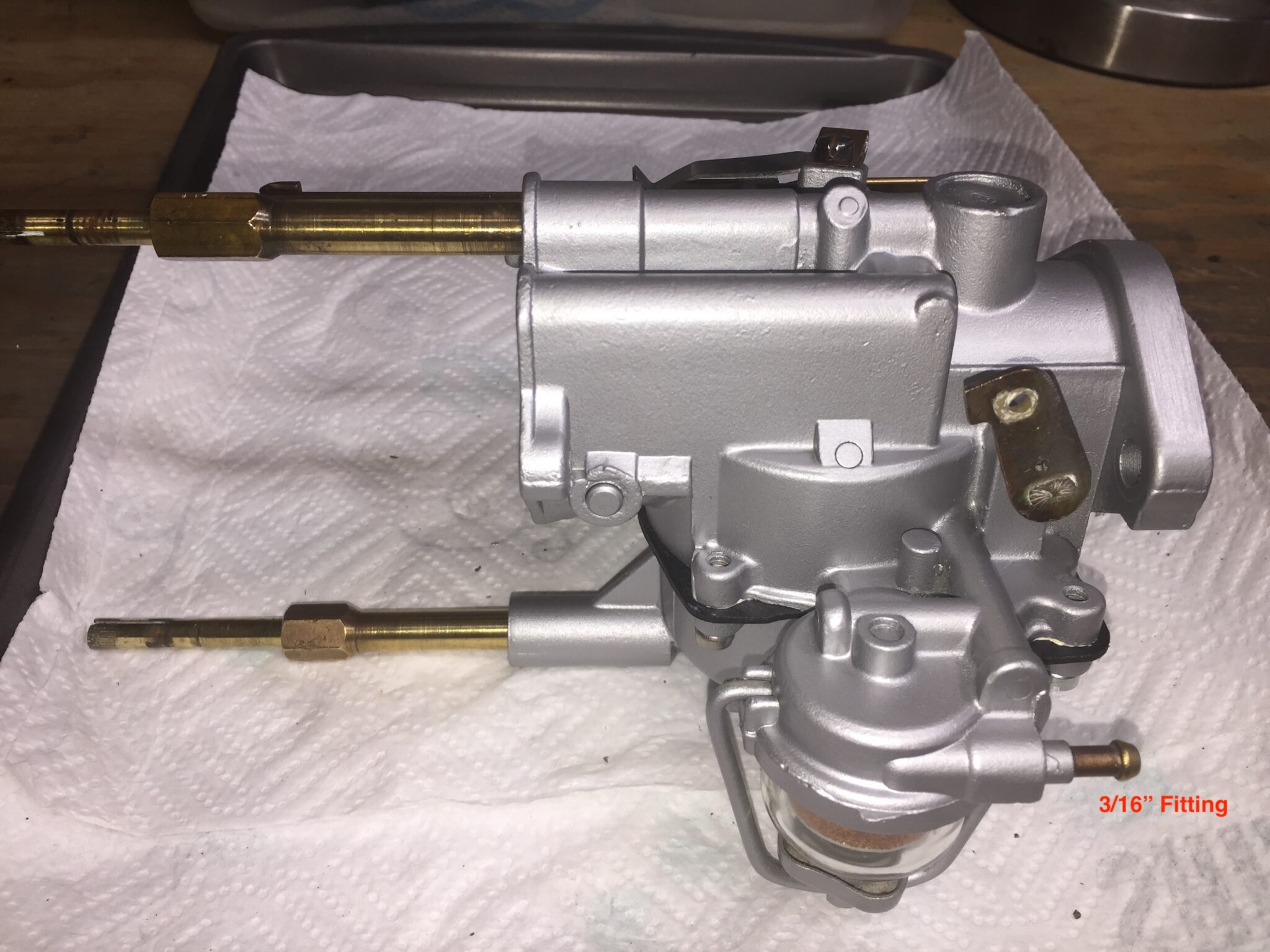

              Here’s the carburetor off my ’56 Johnson 30hp which is the standard model (not a Javelin) and this carb uses 3/16″ fuel line.   I would assume your carb is the same as this one as the only difference between the standard and Javelin models was the cowling cosmetics.
                56-Johnson-Carb
                The other difference is that my carb is not as clean and shiny as yours. : )

                  Well, if you’re replacing the fuel line you can always shiny up the carb too!! LOL
