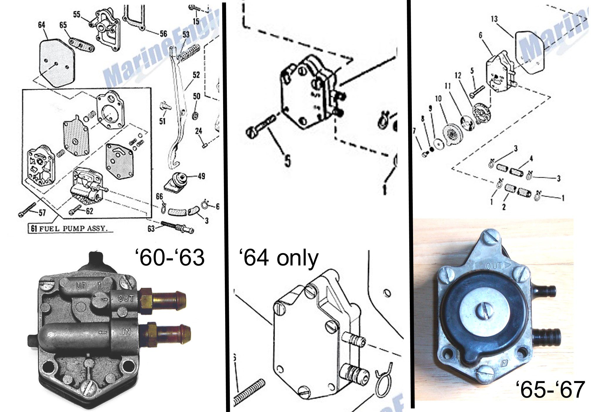

      I would like to rebuild this pump, but I’m not sure what it’s from.  Casting has 304089 on it.  If someone could tell me the rebuild kit part number, I’d appreciate it.

        OMC , mid 60’s … I’m sure that someone here will come up with a part number.

          I don’t believe they made a kit for that early pump. I think an Evinrude 1960 10 hp model 10020 had that style pump. Marine Engine site shows individual parts.

            Look at the parts in  the kits below and see if any look right.  I vaguely remember rebuilding one something like that for a friend and found a kit that was “close”.   If I remember right, I had to do one minor modification to either a kit part or a pump part.

                If the front side of yours is flat it looks like maybe just a one year pump in ’64.
                Same original part number all the way up to 40 HP, #379297.

                  Thanks, all.  It appears to be the ’64 model.
