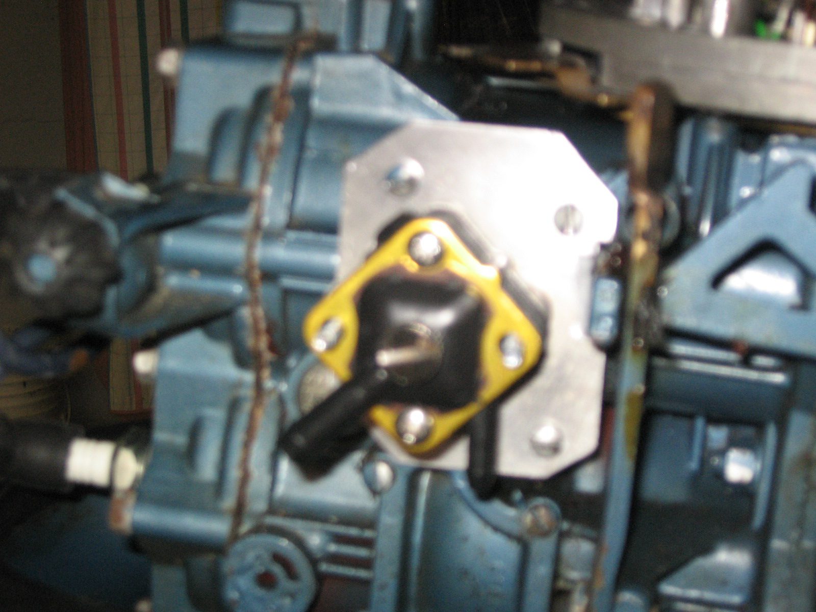

                      actually 90$ seems high all you need is a few feet of hose and a $25 pump. Of course OEM stuff costs more πŸ™
                      see mod on a 10hp of course a side cover plate with mounting holes all ready to drill and tap are best way to go to mount a pump.
                      this one in the picture got me going crazy last summer with 5 bad pumps till I realized my pulse hole was not drilled in line with the back end of the pump πŸ™‚ πŸ™‚

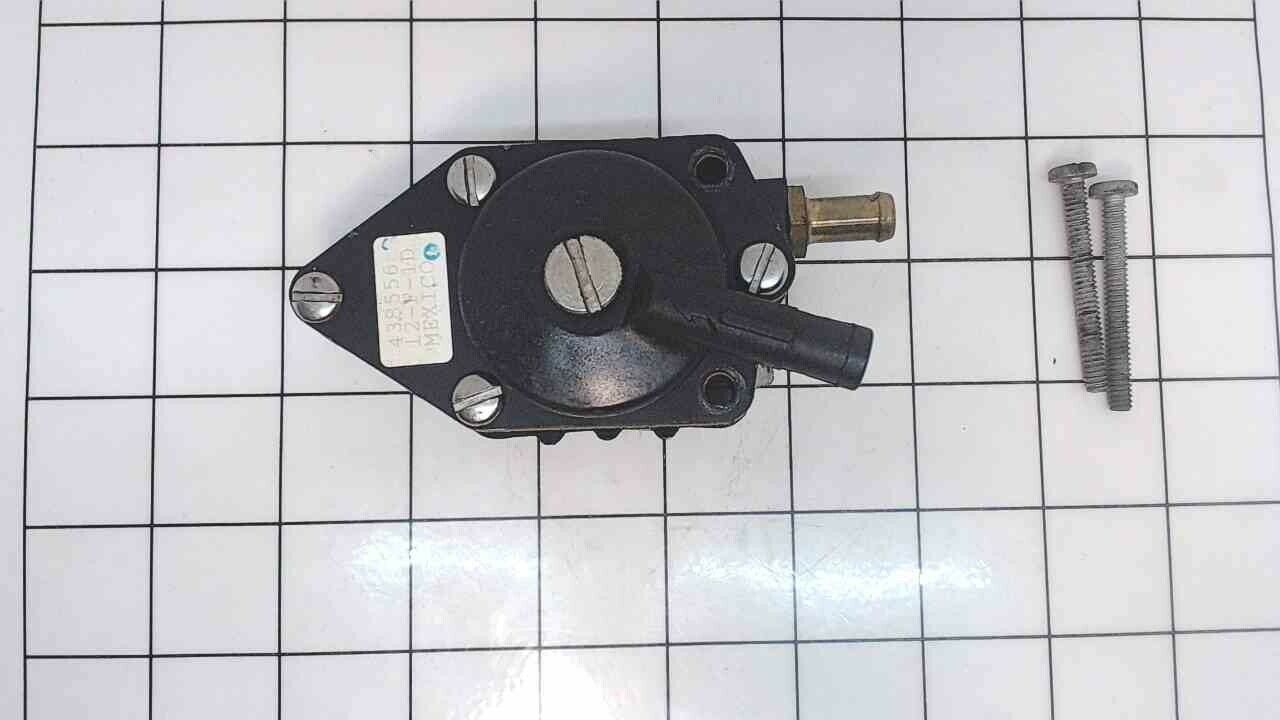

                      #249708
                      jdean
                        Forgot to drill the hole for the fuel pump? Sounds like the time I spent an hour figuring out why my dishwasher wasn’t draining into my new garbage disposal. I forgot to punch the plug out! πŸ™‚
                        The total for this mod was about $60, not $90. I looked at a lot of different fuel pumps. For 25hp+ motors, new OEM pumps were $90, Sierra about $75. The Chinese eBay & Amazon knock-off pumps were $12-15. Fearing being stuck in the middle of a lake at some point, regretting purchasing a $12 Chinese fuel pump, I decided to go for a nice-looking used OEM pump and an OEM re-build kit for it. With shipping, the fuel pump and the rebuild kit for it was about $35. I also purchased a 1959 Gale 25hp bypass cover, part 304646, that was set up for a fuel pump for $15 with shipping. As far as I understand, it should fit my RD-15. I could have made an aluminum plate like the one you pictured above, but this sounded easier. Then with hoses, a bypass cover gasket and capping off the intake nipple, we’re at $60. But… I do think this will be worth it.
                        This is the fuel pump I purchased.
