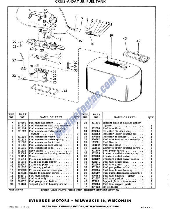

      Does anyone know of somebody making a replacement site window for Mercury fuel tank

        OMC site glass fits fine. I have used them many times.

              i have looked from 1972 to 1985 and cant find the omc round site glass part # only the oval one
              anybody out there have the part number Thanks
              #49144
                Round lenses were used in the OMC pressure tanks thru ’59. P/N 302568.
