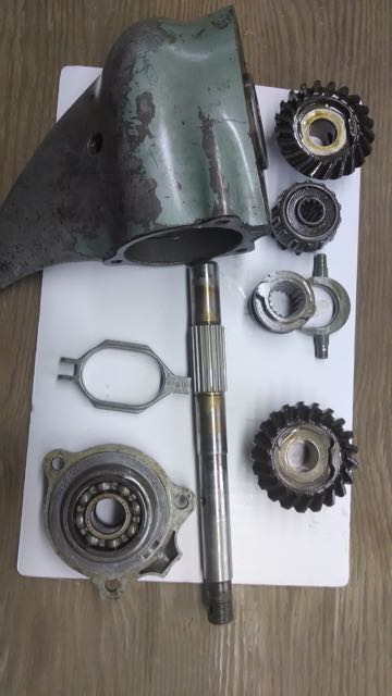

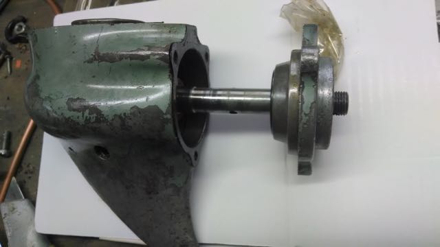

      If that is a split case lower, I have all the innards, if you need them.
      This is not a split case like more modern QD’s. The prop shaft, gears, etc. come out from the rear.
      David,
      I am pretty sure those gears are the same. You should be able to tell by some measurements on each. I don’t think the clutch dog on that motor can be flipped, but the gears could be swapped around if they appear to be the same.
      I think the split case started in 1951 with the QD-12 which is a different critter altogether.

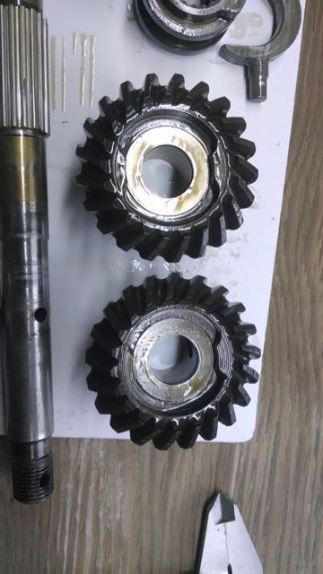

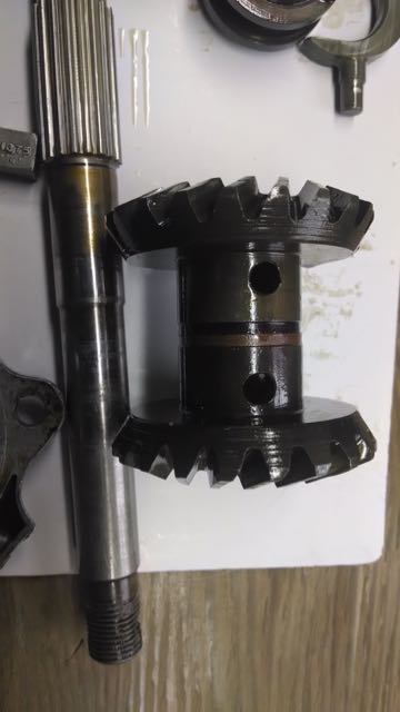

                    I took the gear case apart again to examine the forward and reverse gears. They measure up as identical. I have a NOS clutch dog coming. I’m going to go ahead and swap them.
                    #32454
                    davidk
                      #32467
                      david-bartlett
                        David,
                        That is how I would proceed. I did see a gear set on FleeBay but was $$$$.
