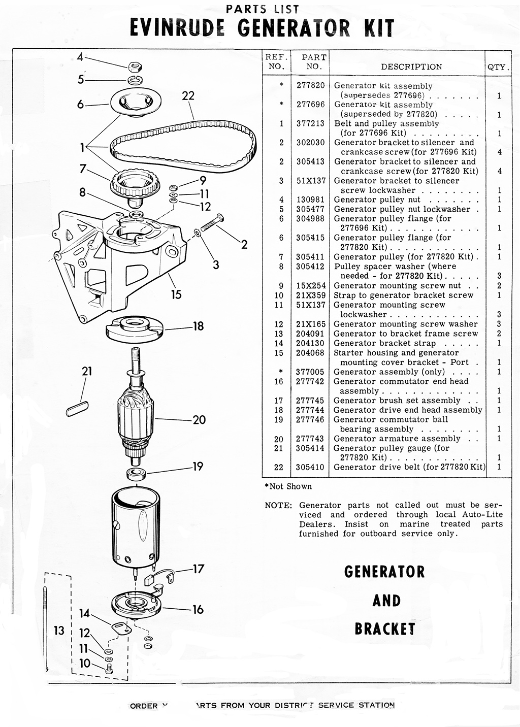

      I’m looking for the part number for an ‘over the counter’ generator belt from an auto supply to fit the late 50’s OMC motors.
      Tall Texan or someone posted it on the old boards and of course I lost it. Thanks!

                #52405
                jiall2
                  Polytech Design Inc. item #B255L037 0.375 inch wide, 68 tooth fits 35hp ’57 Johnson generator
