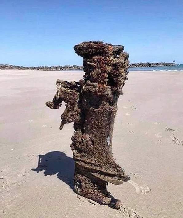

                      And you think you have buildup on your motor, what about this one?Krusty
                      #257905
                      JOSEPH BRINCAT
                        For sale …. It ran the last time we used it !
                        Joe B
