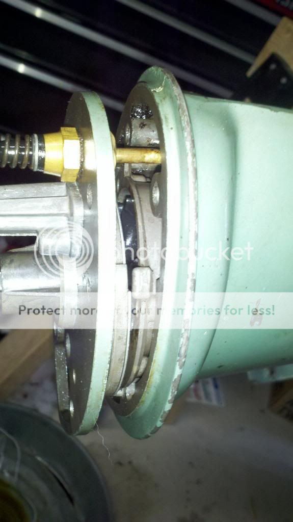

              Water is squirting from the tell tale pretty good but it seems to be heating up pretty fast. My thermometer shows temps in the high 170s. Do these motors run hotter than normal?
              Other than the 4 bolts on the leg, is there anything else I have to disconnect to drop the LU? I have no idea in which decade it last had an impeller.
              #37809
              steveh
                These motors don’t run hotter than normal. It is possible that some of the water passages are blocked, but let’s go with the worn impeller first.
                You need to loosen the neutral cable at the handle on the top of the motor. Try not to pull it all the way through as it can be a pain to thread back. You’ll be able to then pull the plate out of the way and access the impeller. The edges of the plate are pretty sharp, so be careful.
