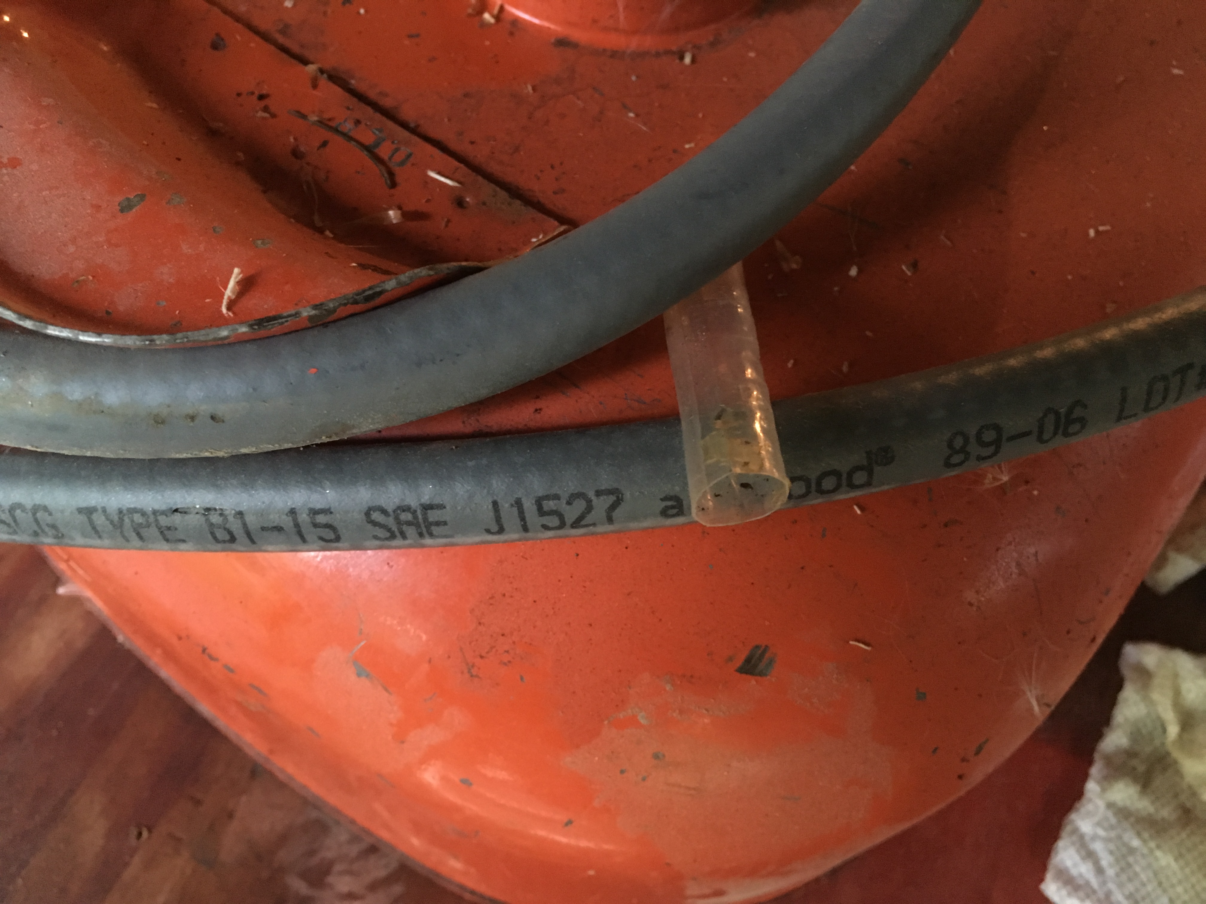

          david-bartlett
            I now make my own fuel lines when needed. Most of my stuff uses the double line pressure tanks so not a big deal.
            Here are a few pics of the problem
