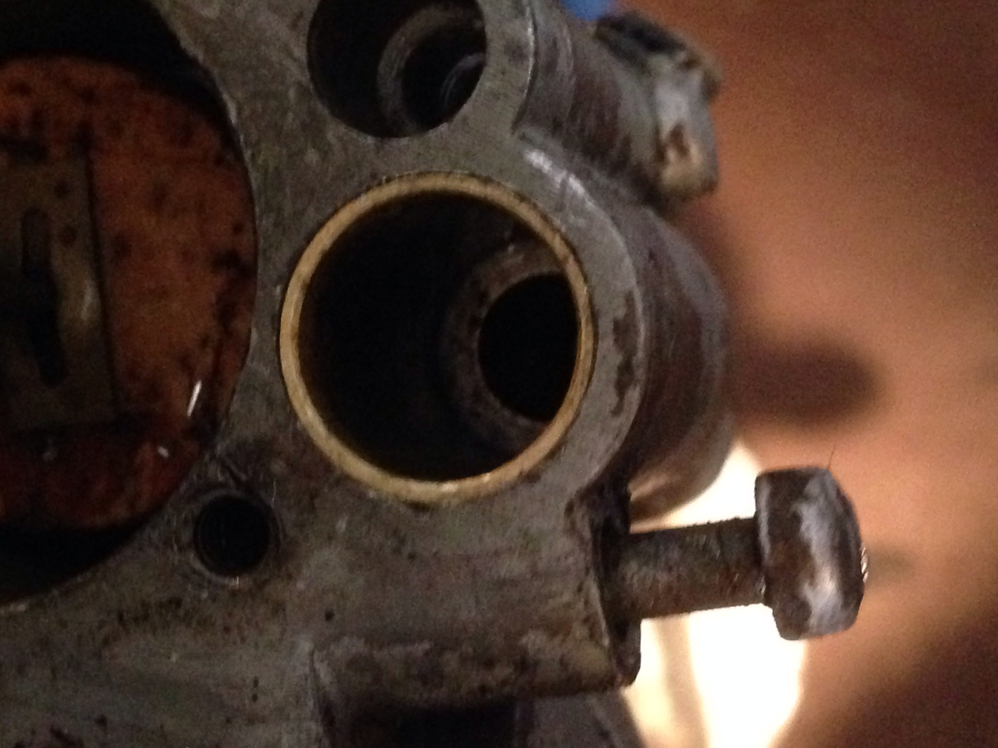

https://aomci.org/forum/download/file.php?mode=view&id=987&sid=771ea0c754a4c4754eb05447de07afe5%5B/img. Does this sleeve have to be removed to access washers etc.Some one had dismantled and re-assembled this carb and some pieces are missing.Parts list and instructions list a sleeve but I’m not sure this is the one.
Yup, that’s the infamous brass sleeve which has to be removed.

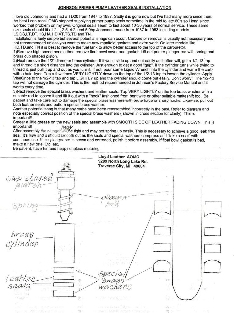

And Lloyds instructions which come with his leather replacement seals.
