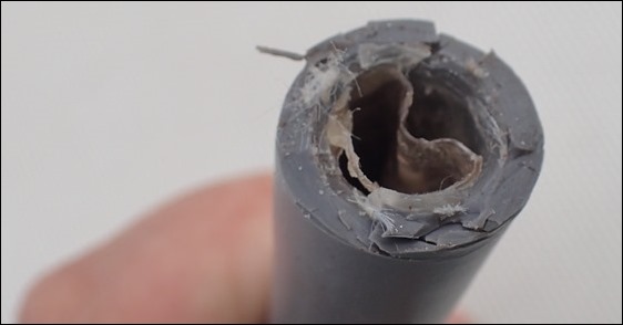

      If so, here’s something I found about the new fuel lines which may be causing the problem.

          PugetSoundBoater
            thanks for the link mumbles, the photos really help understand the problem.

              david-bartlett
                This is a piece of the same crap. I cut a section of hose and could pull the liner right out. Eventually it just breaks up into small pieces that plug your system.

                jerry-ahrens
                  I’ve replaced a truck load of those as well. The only good fuel line I’ve found is OEM, either Mercury or BRP.
                  Here’s a carb bowl off of a Merc 4 stroke. It was running the same fuel line as the one in David’s picture above. The inner liner melted and ended up in the carb bowl.

                  20mercman
                    I just replaced both of my Mercury grey fuel lines as both of them had the inner liner coming out. One was much worse than the other, but both were junk. It about broke my heart to throw away my one Mercury line, as it was so soft an pliable, and the bulb worked so well. I was able to salvage the bulb and the ends, and replaced them with ethanol safe regular automotive fuel line. I kept finding plastic in my fuel filters, darn that makes me mad still!!! 👿 👿 👿
                    Steve
                    P.S. If I hadn’t heard of the issue here in previous posts, I wouldn’t have knows where to look, once I investigated the lines, it was obvious that they were failing.
