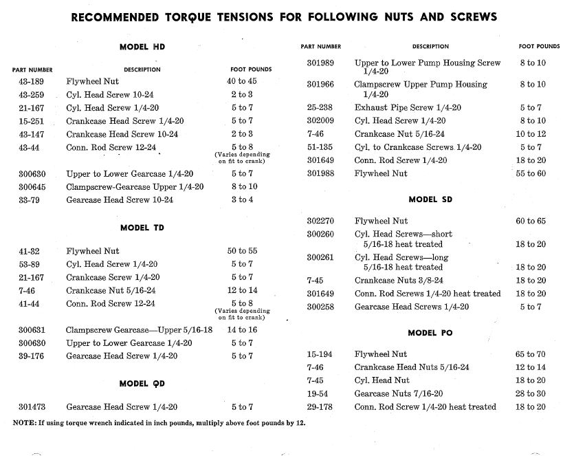

            I could only find Evinrude . . . . 🙁

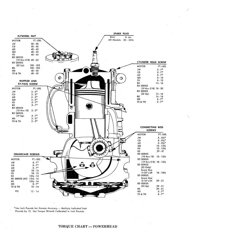

              Here’s some Johnson charts.
              #35361
                The second one is the one I looked at. Found it in the 10th Edition Johnson Service Manual

                  Thanks, I will put both on them in my folder.
