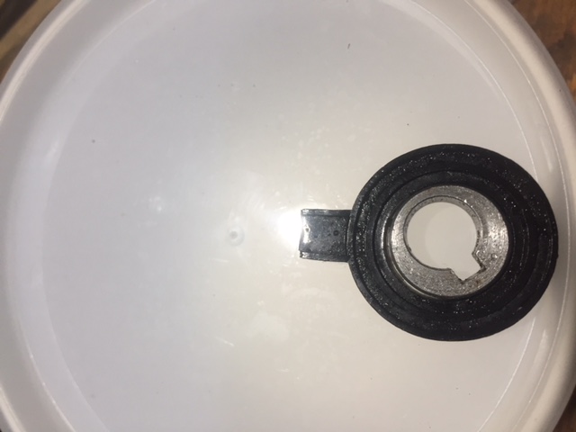

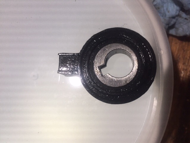

      Soaking that rotor in oil may not have been the wisest thing to do. Oil makes them swell up. Other than that, I don’t know what the problem is with yours.

        I’m having the same issue, everything seems in order except my rotor looks swollen to the eye. Ordering a new one from Brian Tomorrow. Hope I have better luck.

          I soaked it in mineral oil in order to swell it in hopes the cam would fi tighter without any gaps.
          My water pick up looks like the rubber has been trimmed off even with the copper tube. It looks blocked in this picture.
          I’d be interested in knowing if yours works with a new pump.

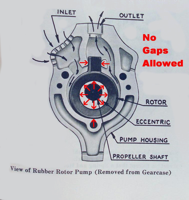

            I have trimmed that piece of rubber at the end that looked rough. Hope it does not have an adverse effect. I’ll find out I guess. Should the pump be a tight fit on the outer rim as well as around the cam? Or just on the cam and loose on the outer area?
            #80548
              ABSOLUTELY NOT ! – It should be a tight fit on the center eccentric cam only. The gap on the outside is for the water. No gap, no water. . . 😎

                      quote Garry in Tampa:
                      Thanks for the diagram Garry. I’ll be sure to refer to it when my new pump rotor comes in.
