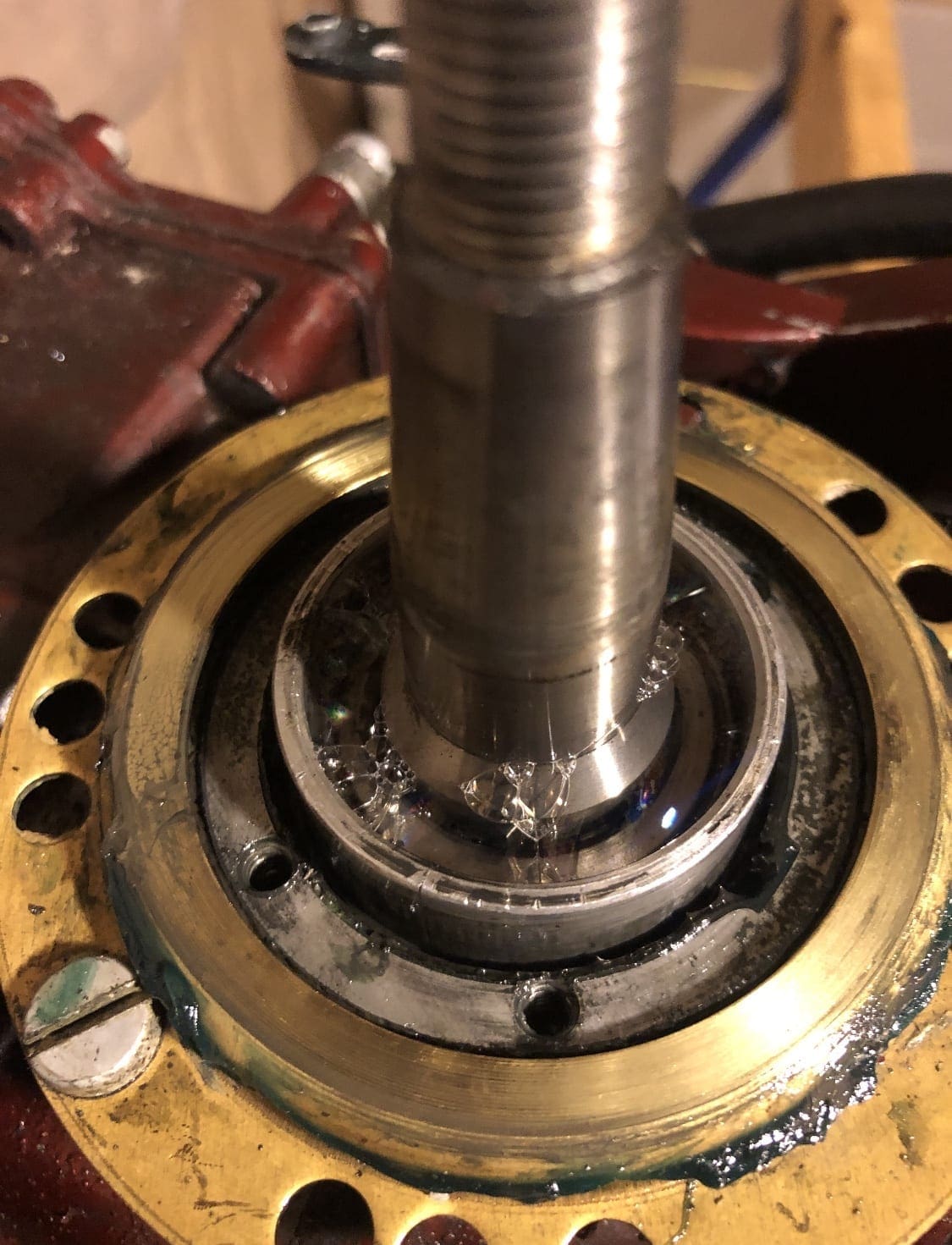

      So it looks like it’s the crank seals. Idk the best way to check the bottom one but the top is definitely toast
      7A2A8B97-E116-4EAC-9DFE-E88DB534633A
      • This reply was modified 6 years, 6 months ago by Mumbles.
      #178983
        do the top one and retry.. maybe the bottom one is ok ??
        looks like it is a simple O ring on the bottom but the head must come off .
        #179038
          Do I see metal shavings/chips in your picture?? If so, you better figure out what made that mess before doing anything else…

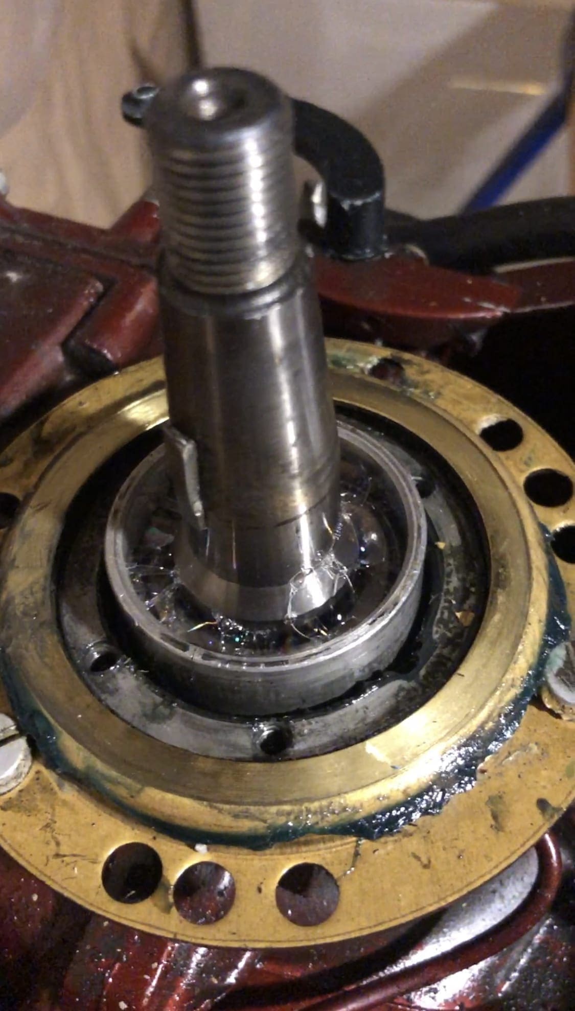

          #179040
          ErikL
            If you’re referring to the yellow flecks by where the mag plate bolts down it’s just random debris from the dirty rag I was using to clean out the grease in there. Not from the motor 👍🏻

            #179046
              looks like bubbles to me.
              #179053
                What you describe is definitely a sign of leaky crank seals. You can confirm a leaky top seal by pouring some TCW oil or fuel mix over it and turning the motor over. Any bubbles showing and you know it’s leaking. If the top one is gone, there’s a good chance the bottom one is to so both of them should be replaced at the same time.
                https://youtu.be/cXt6fV6Z5rc
                #179147
                  You are so right, and I am so blind…..The air bubbles looked like metal shavings to me….Duh…..Sorry

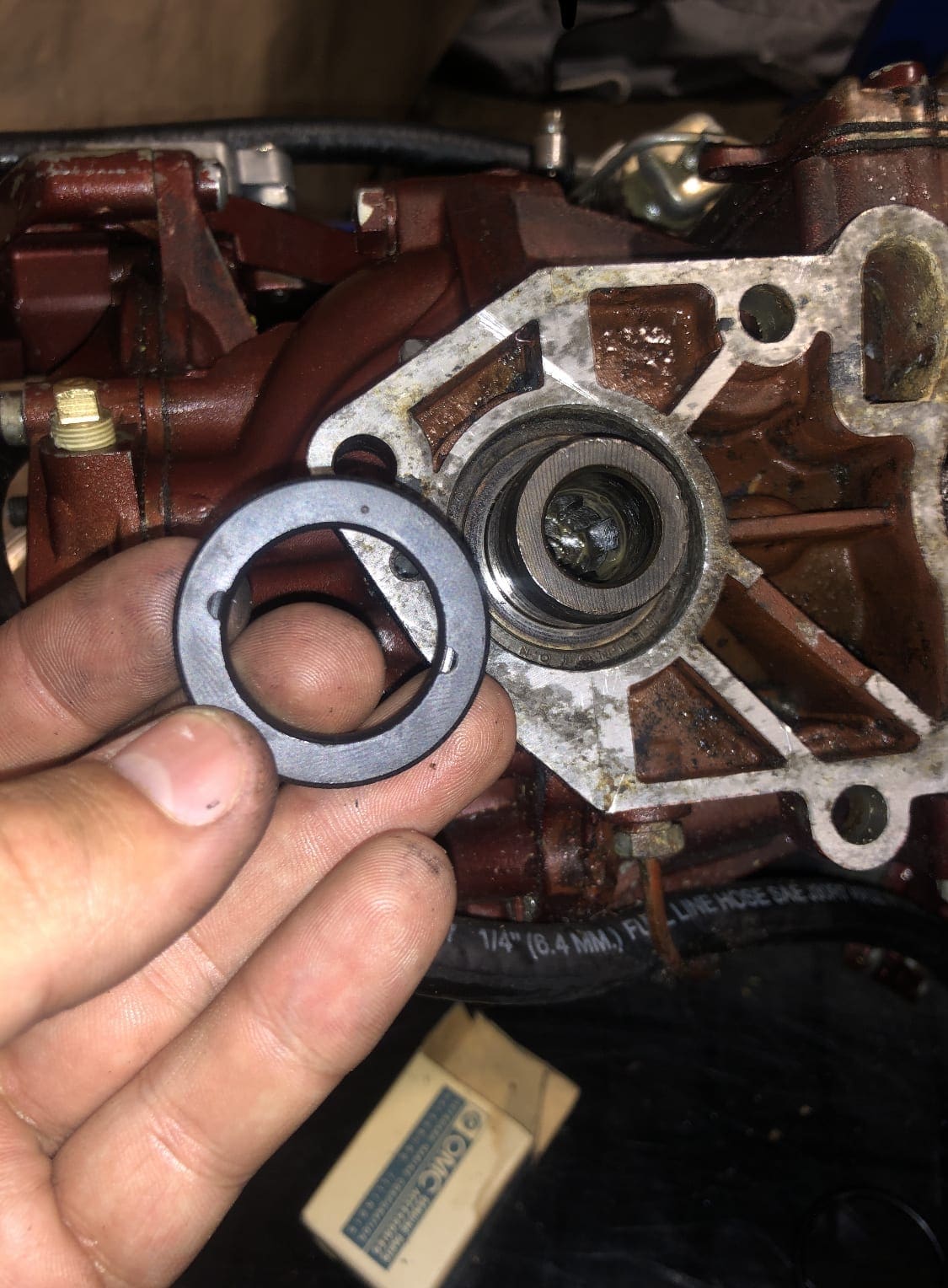

                      Ok quick update and a question. I got the powerhead off and I’m wondering if this hard o-ring carrier gets grease between it and the bearing or gets a sealing compound around its edge. Does anyone know?
                      22D7395F-9B02-4D24-9AF6-62897C10E6E9
                      #179413
                      David Bartlett
                        No sealing compound needed. Just grease the new O-ring that you put inside. Better to use a “Quad-Ring”
