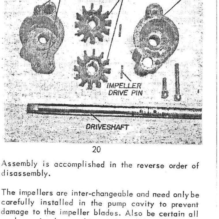

            #157408
              According to this page 103 of the Scott master manual, the two impellers are interchangeable.
              But what it does’t say for what year or models of Scott motors. Some of the photos in the manual
              appear to be circa 1960 ish, but I can not find a date.
              Bailer-Impellers
              • This reply was modified 5 years, 4 months ago by Mumbles.
