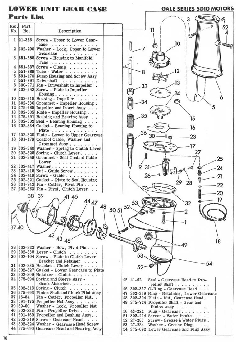

      Hey all so I’ve got a gale build Hiawatha 5 horse with the neutral switch and I’m having a hard time finding the eighth size seal for the prop shaft. The ID is 0.490 and the OD is 1.000. I can’t seem to find one that’s the right size

        Part number 41-62, replaced by 307563, replaced by 321788 wherever OMC/BRP parts are sold
        OR Sierra marine 18-2032
        Pg-18-Lower-Unit-Gearcase-1

          Man that you so much! I don’t know how your find those parts diagrams like that but boy do they help
