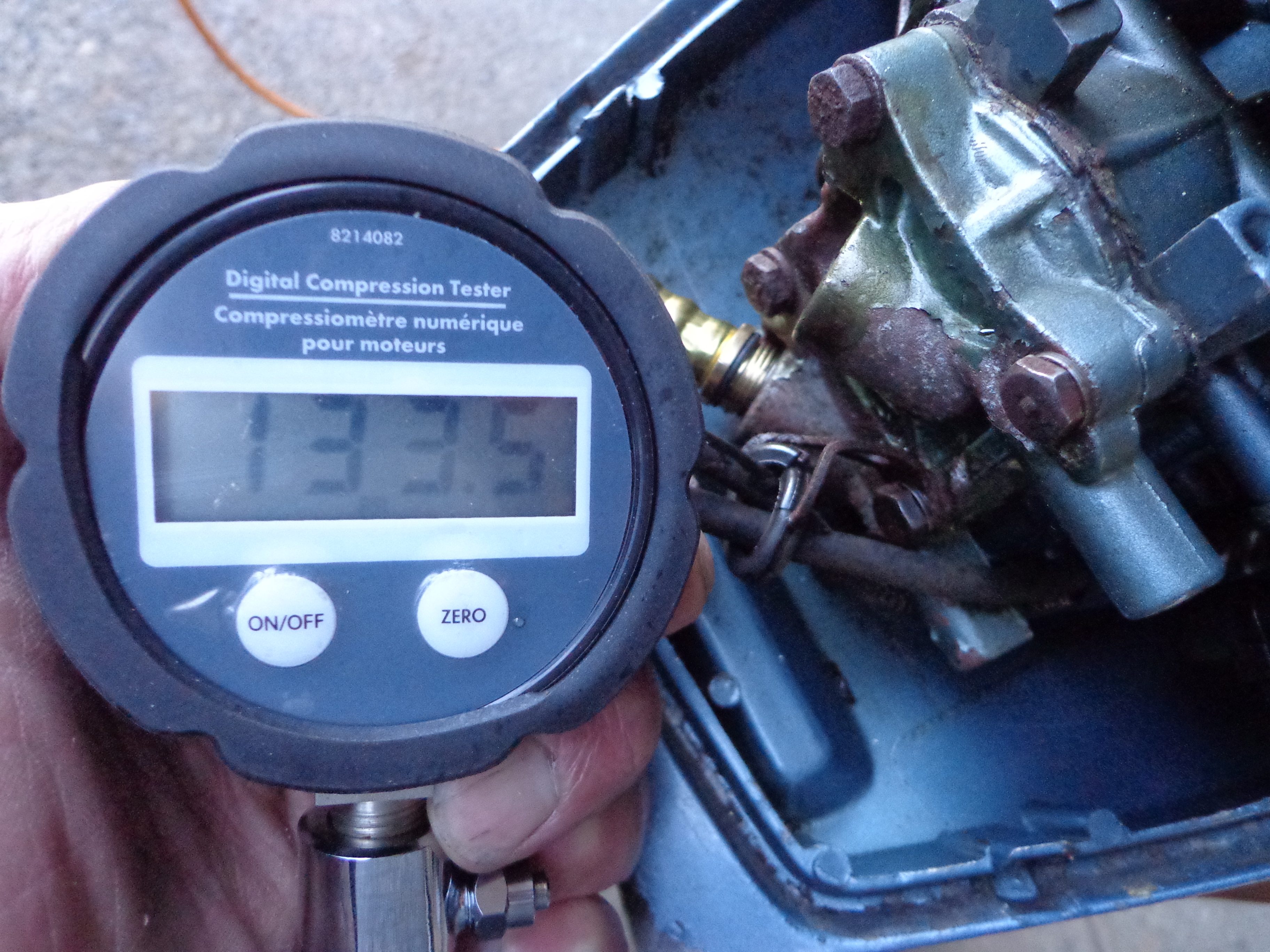

          Mumbles, nice compression gauge. Bet it was made in Canada. 🙂
          Robbie Robertson
          #54091
            Yeah, bore and stroke were unchanged from 69. But, I’m sure the ports and head were different…Bigger intake manifold as well.
            #54104
              I am sure we don’t make those things in canada 😆
              #54109
              mercuryman
                Is you Gage reading PSI , My 1971 4 hp Lightwin reads 90 PSI which is higher than the 3 hp models.
