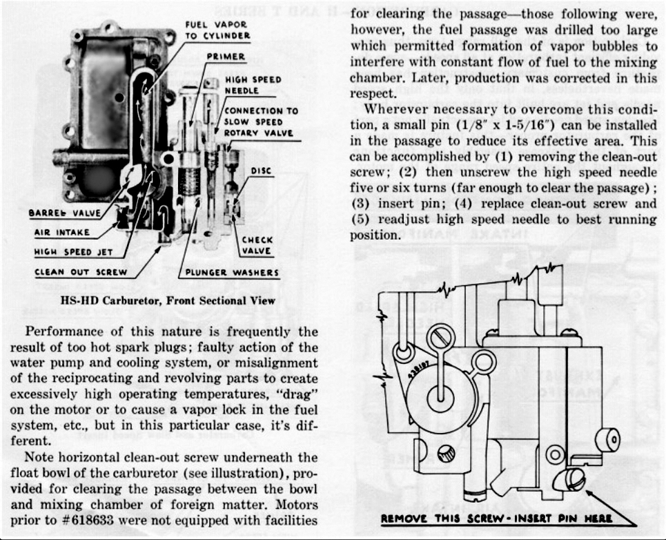

        #60975
        gjonz
          There is a service bulletin showing some of those motors have too large of a passageway from the float chamber to the intake. They require a pin be cut and inseted in the passage toe reduce surface area which eliminates vaporization of the fuel by heat from the exhaust.
          These motors have a flat head screw/clean oh at the front bottom of the float chamber.
          Greg
          #60983
            This from the Johnson service manual . . . 😀
