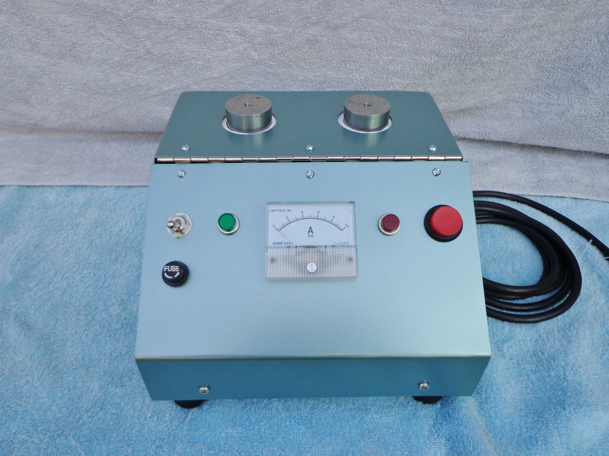

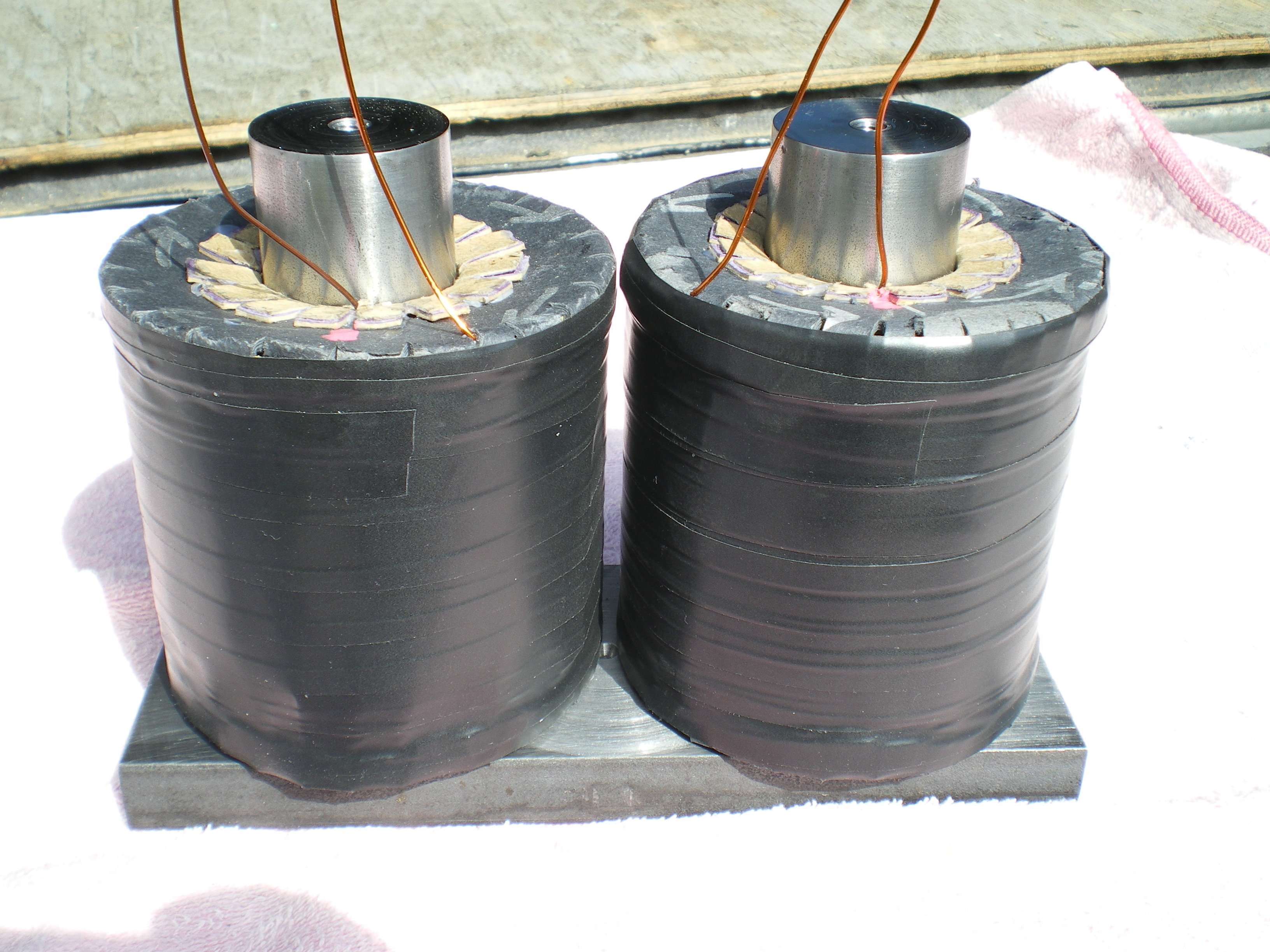

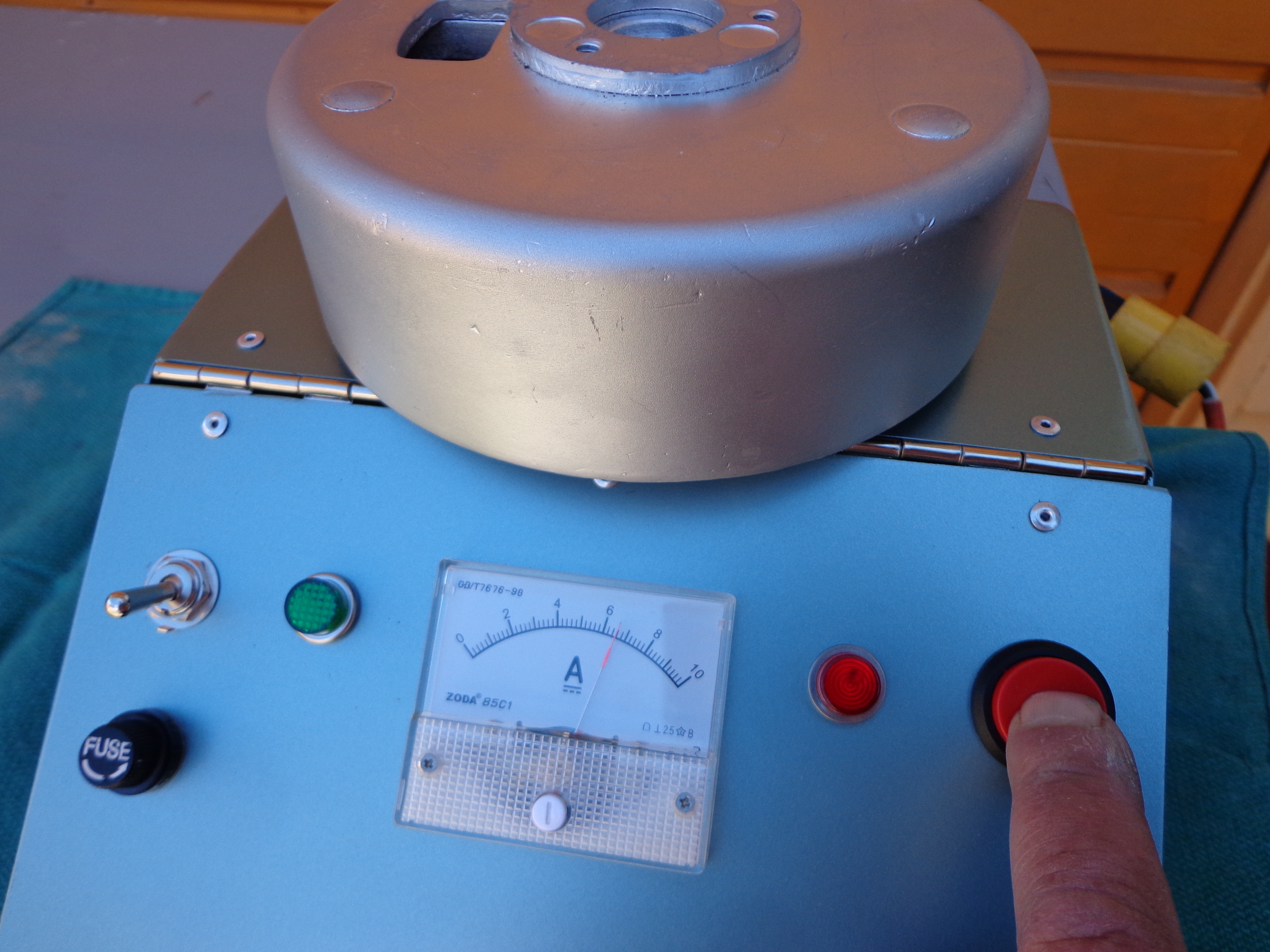

            With no luck searching for a magnet charger, I ended up having to build one. It wasn’t hard to do and took more time than skill.
