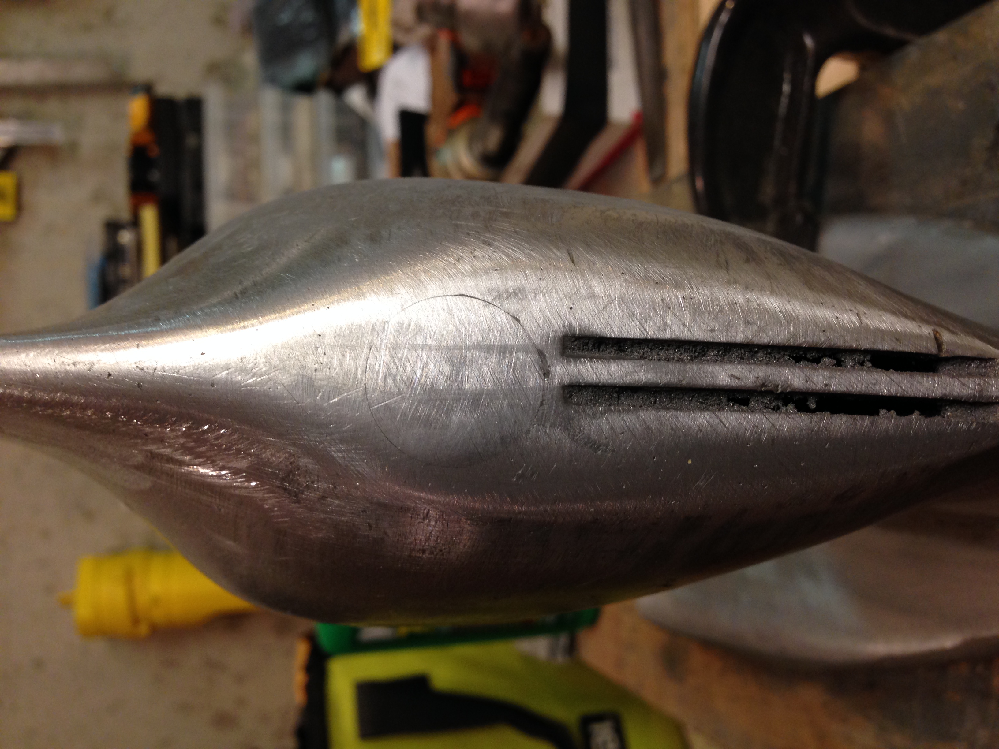

November 18, 2015 at 3:27 am #27278I have been tinkering on the SpeediFour as I have time. I have cleaned the points and carb. I have the lower unit off to clean out the old grease and check gears and bearings. So far all looks good. I will post some pic’s before I reassemble for those who may be interested.
Today’s question refers to the gearcase itself. On both the SpeediTwin and the SpeediFour, the cases appear to be identical on the outside. Gears may be different, and prop is different.
The case of the Four is missing the aluminum plug on the forward side of the gearcase, immediately in front of the propshaft. Is this plug necessary to keep water out, or is it cosmetic to make the case more streamlined.(HaHa, as if this case is streamlined to begin with.)
The attached picture is similar to mine, but mine do not have the extra wings. You can see the "Plug" area right below the water intake slots.
http://i.ebayimg.com/images/g/s9wAAOSw9 … -l1600.jpg
This is what my SpeediFour looks like.
And my Speeditwin. Love the greasefitting!
November 19, 2015 at 2:21 am #27351Today I took the lower unit of the SpeediFour completely apart and cleaned the gearcase out. The "plug" I asked about in the above post is not cosmetic, but needed to keep water out of the grease. I can see the rollers of the front prop shaft bearing through the hole now that things are clean.
Other than that it looks very good inside. Except for that window in the front.
