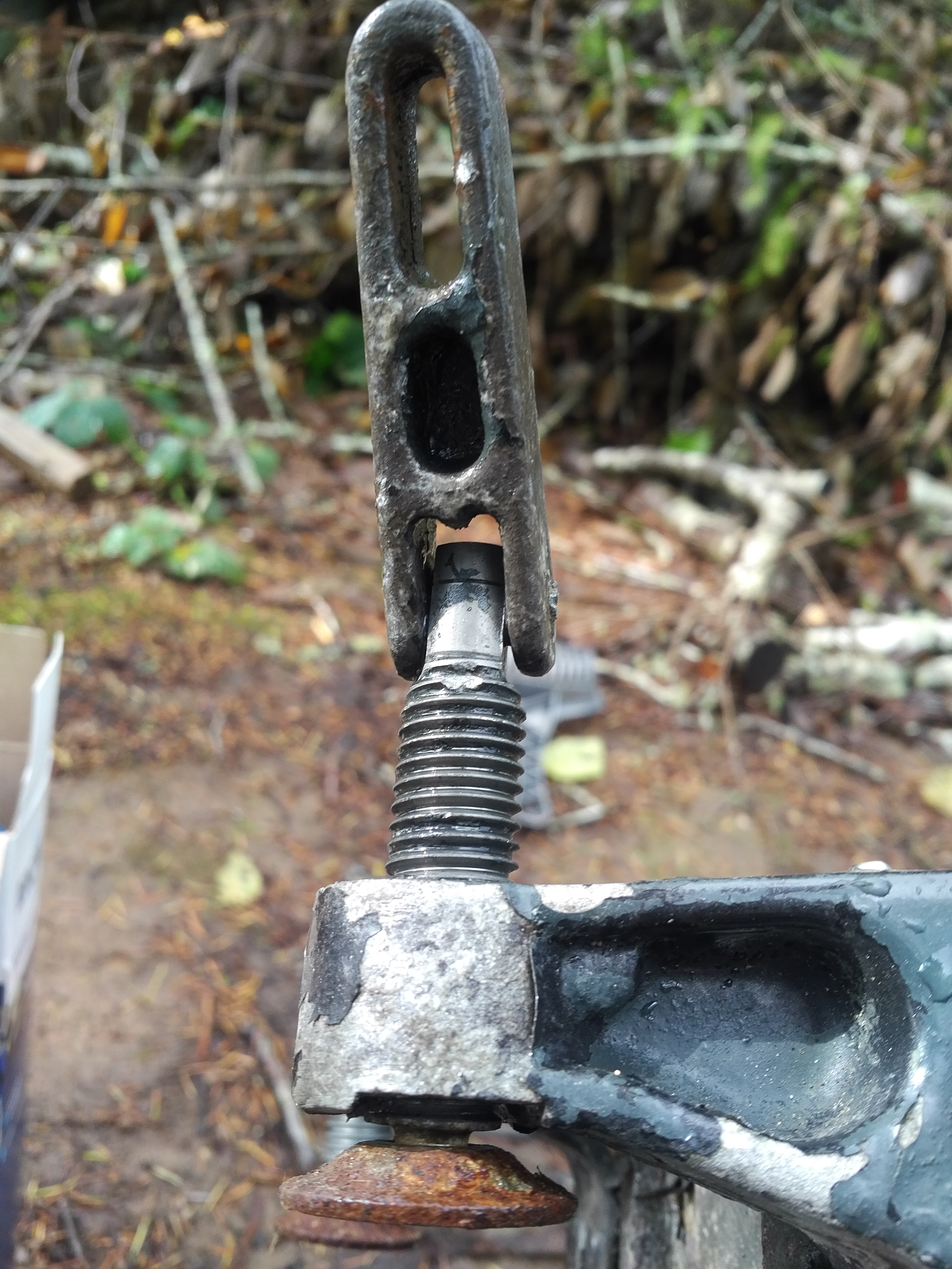

        He said the transom clamp handles are the commercial version I will take a better photo of them and post.

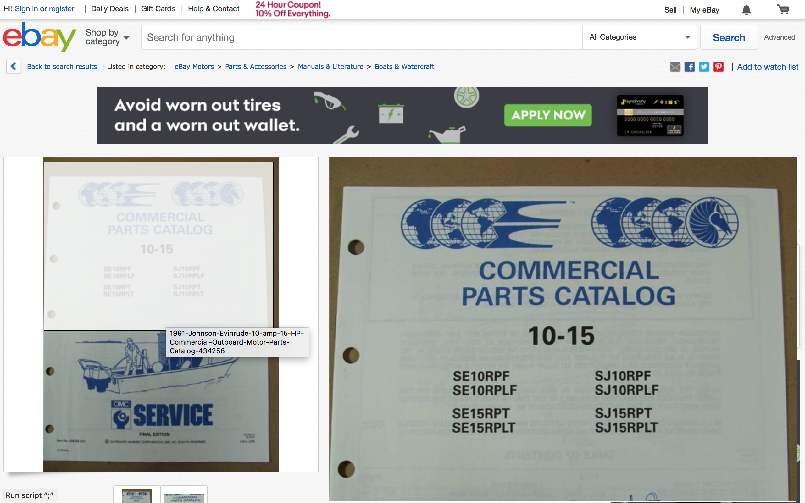

        I got on ebay and found tons of J/E commercial parts catalogs .Notice the design/logo at the top ,same as the cowling. The Johnson Seahorse symbol on the right end looks kinda evil. EDIT

          shown is a transom clamp off this 15hp commercial motor. The clamp screw handle and rivet is availiable to order separately. Part# 0398001 is not cheap at $56.91 ,but they are stout aluminum.

            And yes, some of the the commercial models came factory equipped with those beefy transom clamp screws.

              I’ve seen lots of service motors with one ordinary clamp screw handle and one like the one shown. Maybe an option for locking the motor?
              #85108
              PugetSoundBoater
                quote Mumbles:
                I noticed where you could slip a lock or small cable through the clamp handle on those beefier handles. A lock slipped through the hole in the plastic recreational motors would not offer much security.
