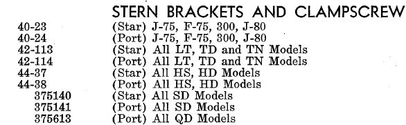

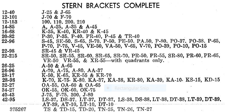

      I would like to find a port transom bracket for a Johnson 300. Since there don’t seem to be a lot of 300 parts motors out there, can someone verify whether the brackets for the 100 or 200 are the same? The Johnson parts manual lists the port bracket for the 300 as 40-24 (JAWWE).
      Thanks for any help you can offer,
      Tom
      #50791
      eltoquad
        The F75 brackets are the same, and probably just as hard to find.

          Tom
            Excellent, thanks!
