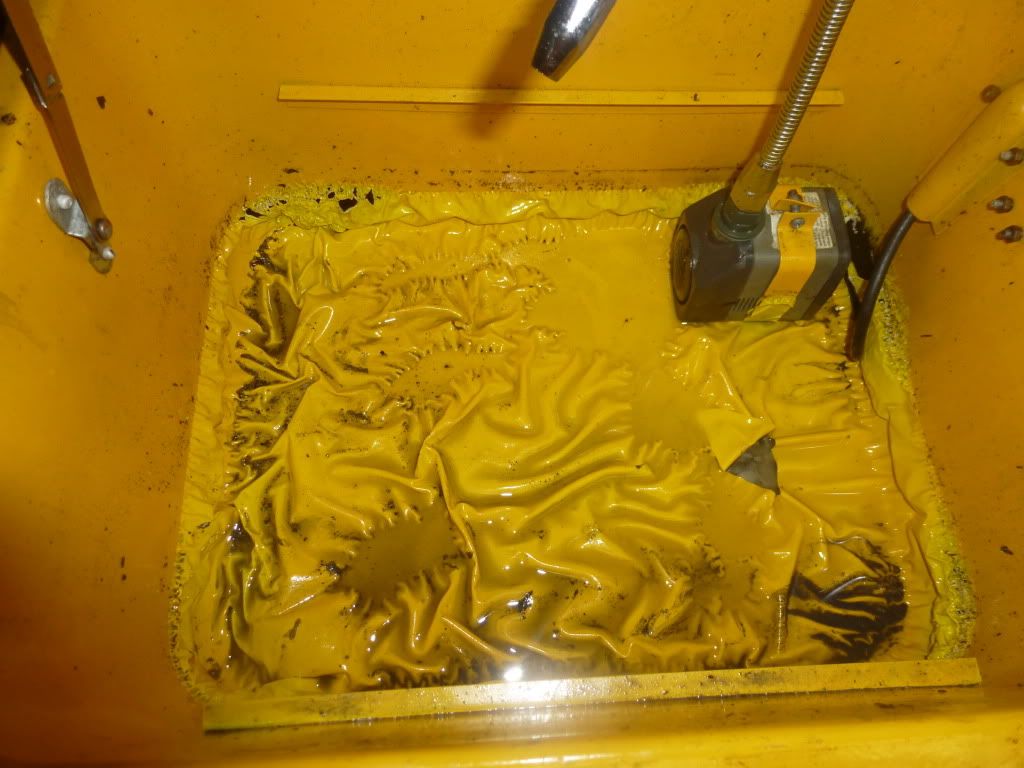

      chris-p
        Here is what I used, and what it did to an almost indestructible parts washer tank
