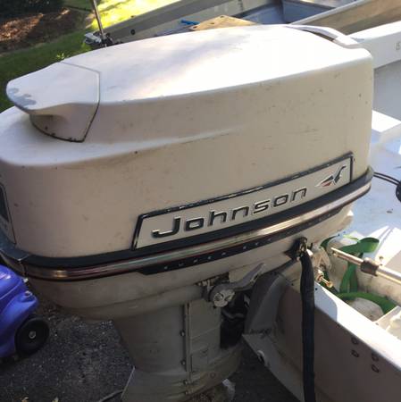

      This is on a Johnson 40 hp. Can anybody help me confirm that and get the details?

        As a serial number, that would make it a 1961
        The 40hp models made that year were:
        RD-23
        RDL-23 long shaft
        RDS-23 electric start
        RDSL-23 electric start, long shaft
        The hood would be white fiberglass (with silver on top)

          It is electric, but hood details are different.
          Would this be in the range that had a weak crank for 40 hp? How does one know?

            The hood looks like it could be 1964, But I would expect that all the 1960’s 40hp covers would interchange:
            https://web.archive.org/web/20050826170 … _1964.html
            https://www.youtube.com/watch?v=gNVqTQXztkAB
            Finding the model number, which would begin with "RD" on the block plug, or the transom bracket, would be the BEST indication of the year.
            I think 1962 was the year with the heavier crank.
            Wait, the last serial for 1961 is 2,249,094 so J2457020 is later, and could well be 1964!

              Compare that serial number with the one on the ID plate on the transom clamps (if it hasn’t been removed). If it doesn’t match, someone swapped powerheads. The ID plate should also have the model number.
              #45042
                Small crank used a 7/8" wrench to remove flywheel. Large cranks use a 1-1/16" wrench. So, look at the nut

                  It is an RDS-26R.

                    1964
                    #45090
                      That would definitely be the big crankshaft – no worries.
                      #45097
