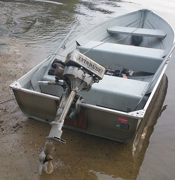

                #32674
                  This picture is of Richard Lpaquette 1936 8.5 HP Viking model 496.
                  You can see the similarities.
                  Here is a link to his web sight.
                  http://www.richardlpaquette.ca/Vikings.htm

                    And again, Tubs comes with the evidence, glad to see that you take the stand and speak for Richard
                    I began to doubt what I wrote earlier !
                    thanks a lot, thumbs up for you ๐Ÿ˜Ž
