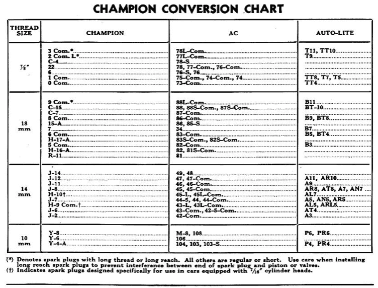

        #171127
          Here is what I have –
          1949-Champion-Chart
