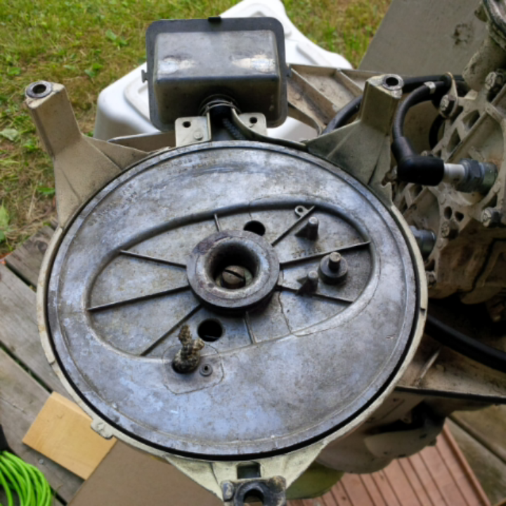

        mgsolakis
          Here is a picture.
          #40760
          chris-p
            You need:
            2x 203713 Link Connections
            1x 203697 Starter Pawl Spring
            1x 203698 Starter Pawl
            1x 203470 Retaining Ring
            If no one close to you has what you need let me know. I have a large assortment of OMC parts.

                #40808
                  The thing to remember here is that flywheel size/diameter changed in 1958 for the 10hps. So, the location of the engagement pawl on the recoil changed as well. So, if the flywheel/recoil are mismatched, you will have an issue….The starter on the right, with the pawl closer to the hub, looks to be for the smaller diameter flywheels on the 1958 and up models. The starter on the left, with the pawl farther out from the hub, looks to be for the larger flywheels on pre 58 10hps.
                  #40811
                  wedgie
                    quote fleetwin:
                    Very good to know Fleetwin ! I learn something new every day !
                    I assume if you swap both the flywheel and starter together everything should work out, or are there other factors involved ?
                    #40817
                      quote Wedgie:
                      quote fleetwin:
                      Well, this is not something I figured out, was pointed out here earlier by Frank I believe. But, I’m thinking that you could use the smaller diameter flywheel on the older motors (56-57 models) with the newer recoil. And, I’m sure you could go the other way as well, put the larger diameter flywheel and older starter (56-57 models) on the newer engines (58-63). To clarify, when I say "starter", the only part that is different is the recoil pulley, I’m pretty sure the housings are the same on both styles of starter.
