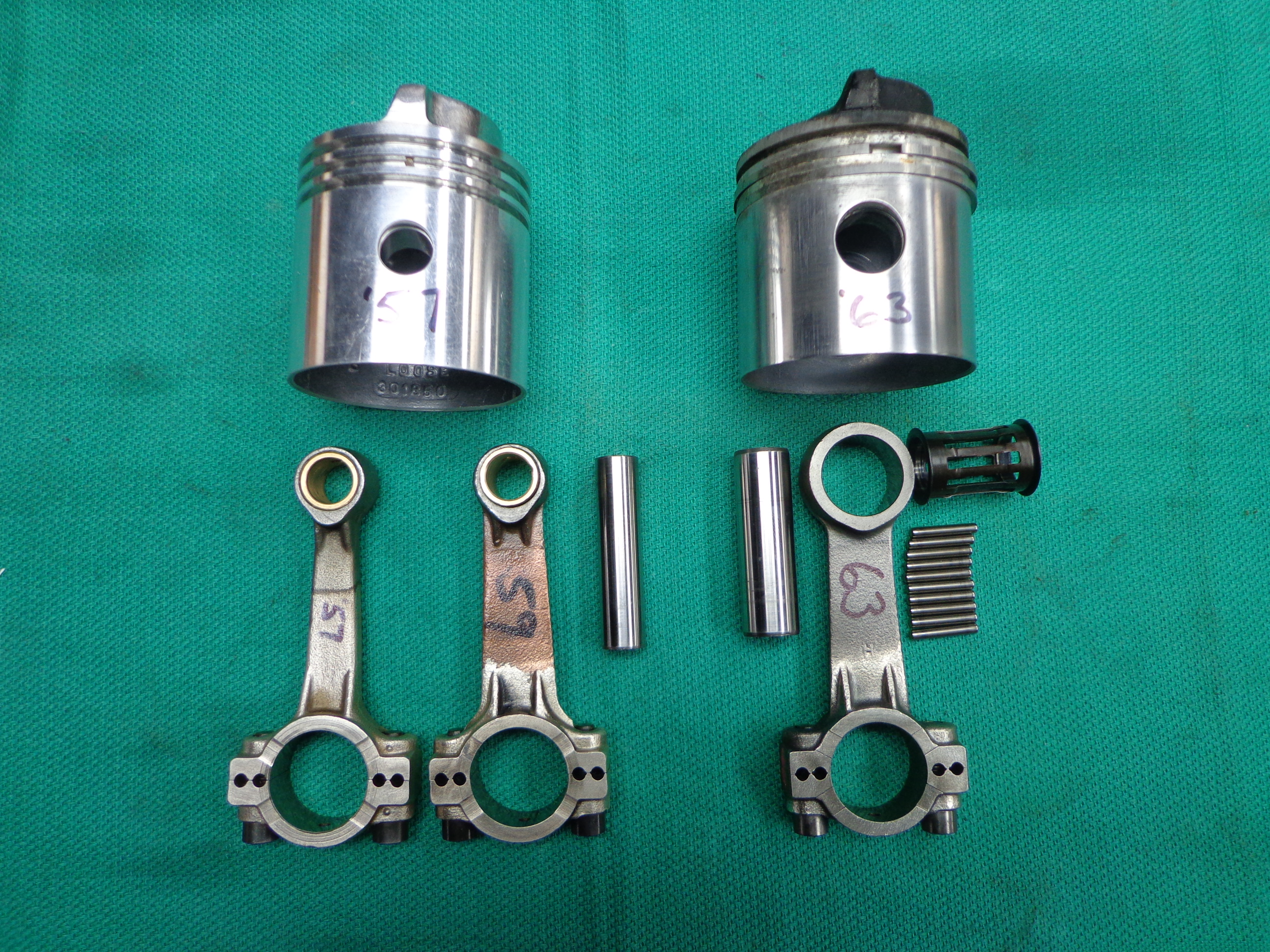

            mr-asa
              quote Chris_P:
              If you want to upgrade your pre ’61 10hp powerhead, order the following:
              Wrist Pin 307849 x2
              Connecting Rod 378330 x2
              Piston 378285 x2
              Needle Bearing 378251×2
              Big End Needles 378150 x2
              Piston Rings 378416 x2
              Circlips 302577 x 4
              Then if you have her apart, might as well change the carbon seal o rings
              301967 x2
              How far back does that go? Down to the QD14? the QD13? Any pre-61 10HP?
              #39333
              dan-in-tn
                I believe it goes all the way back to QD-10? Someone will correct me if I am wrong.
                Dan in TN
                #39340
                  QD or Sportwin stuffings.These should all fit.
                  #39345
                    Great picture!!! That pretty much explains it.
                    #39348
                    1946zephyr
                      I actually have a ’55 QD in pieces now. Fortunately, I found a good rod set out of a ’53, so I won’t need these mods this time. Will keep this in mind though.
                      #39355
                        Tip: The wrist pin bore in the piston is usually worn even worse than the bushing in the rod.
