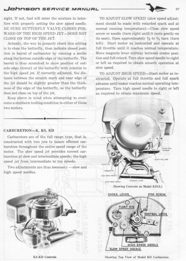

                It was designed in the early 1930s. Early models did not have the sealing rings and used 40 wt. oil. The sealing rings worked so well they use them on the V4 and V6 outboards. I hope this helps. . . 😀

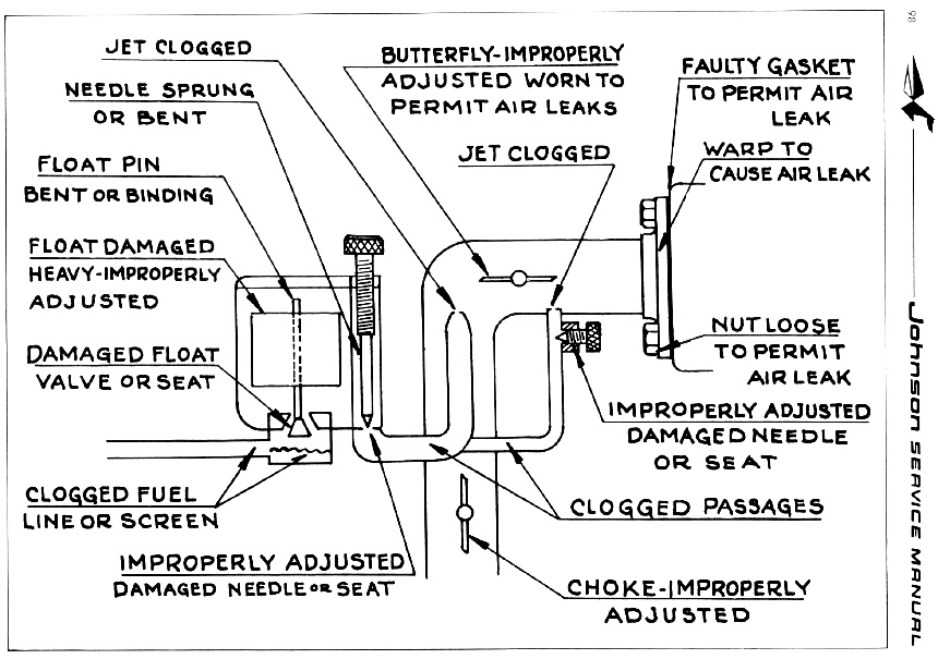

                This is generally where to look for problems – Good Luck
