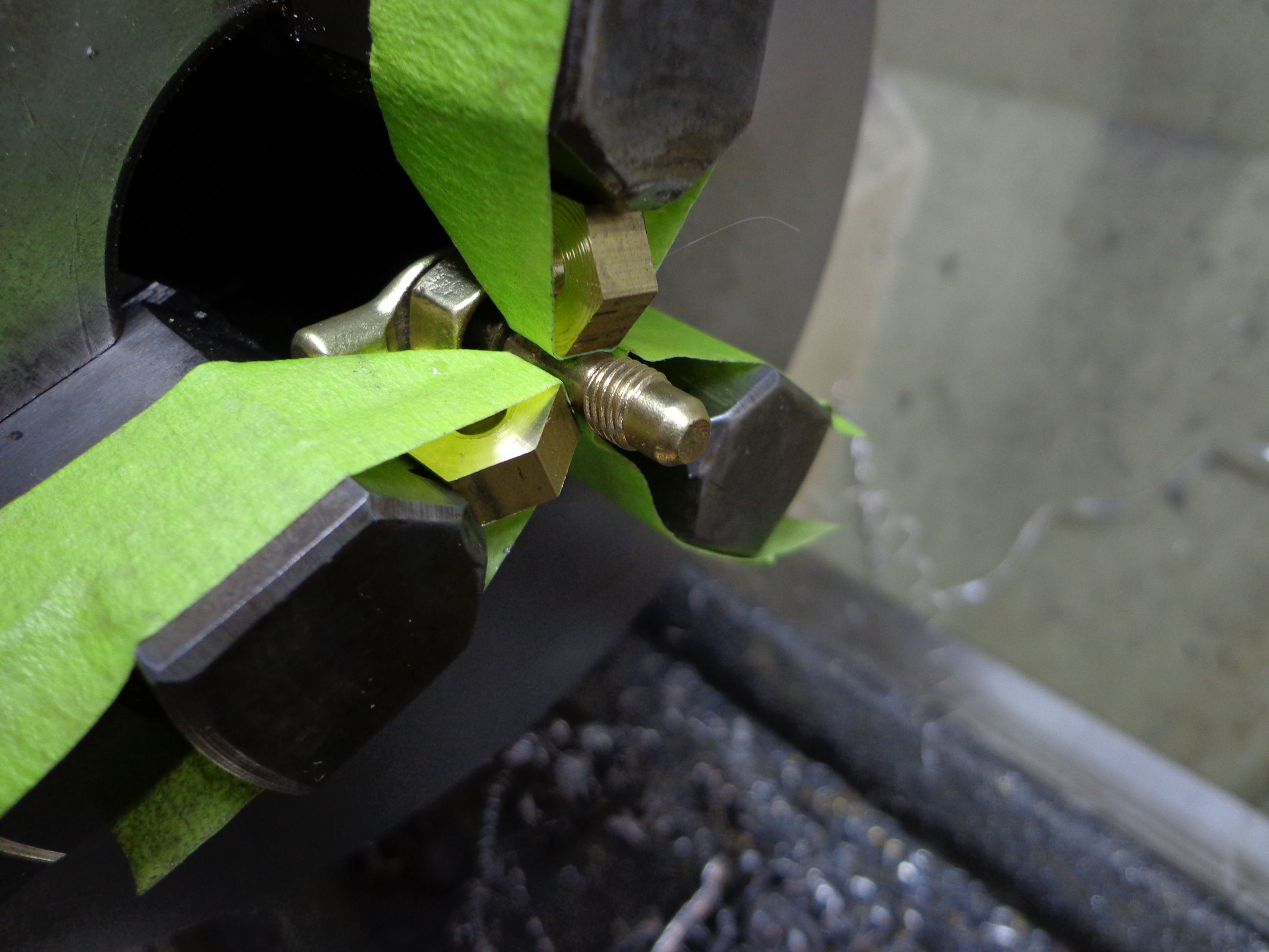

          #54014
            If the end of the fuel tap is grooved or damaged, you might have to chuck it up and spin it.
