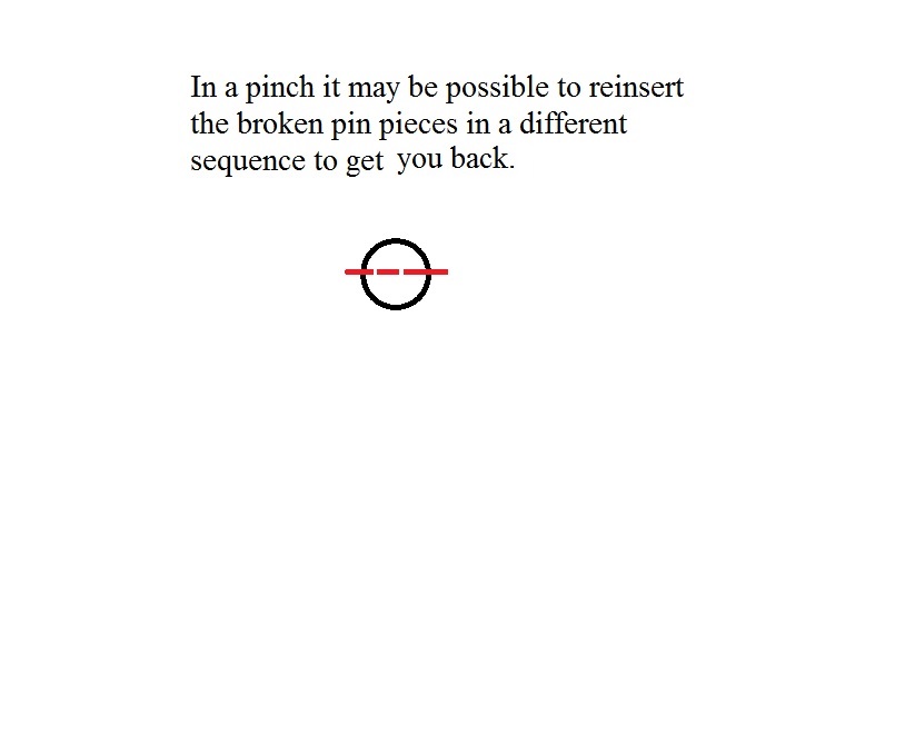

                #37985
                  I would do the reassembly trick when I was a kid in the late 50’s worked every time . EXCEPT when I dropped a piece”
