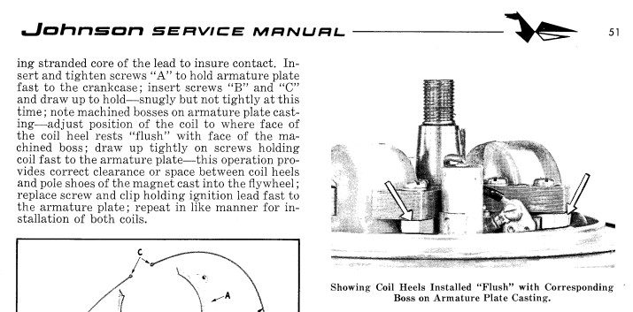

If you don’t have the coil alignment tool…
