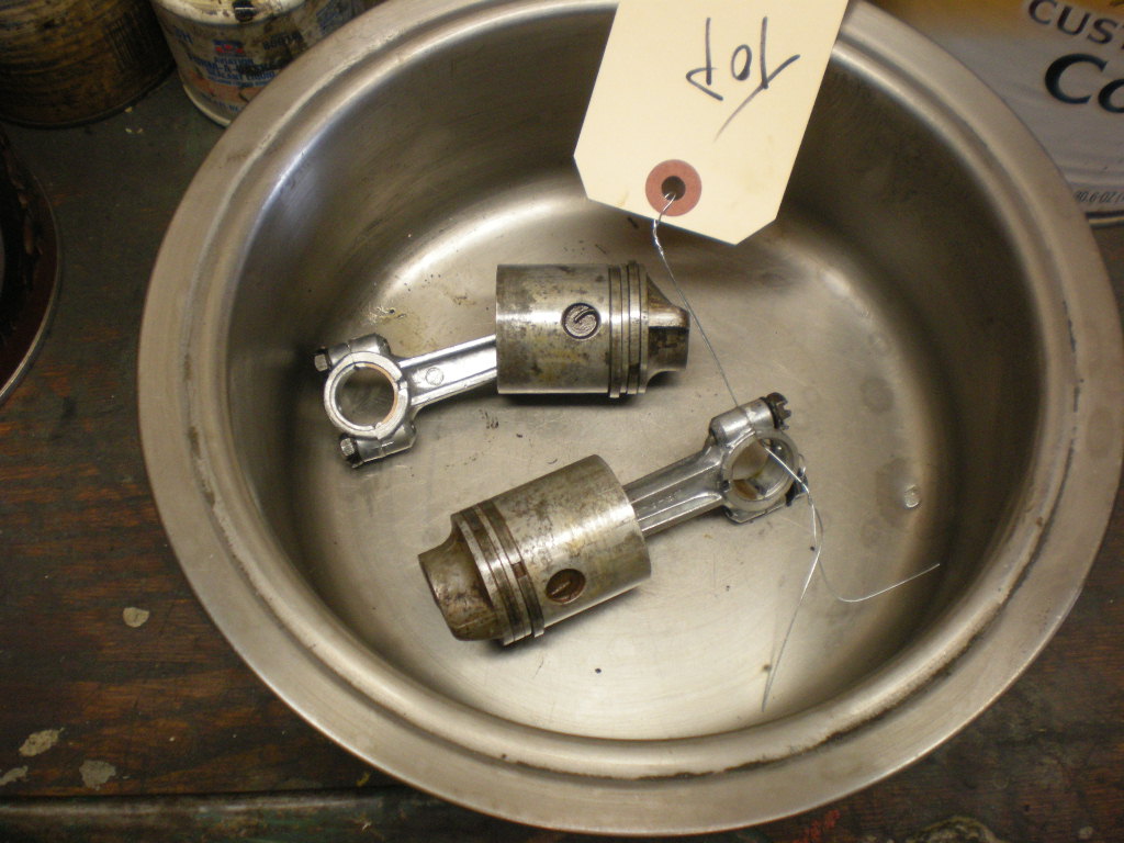

April 3, 2017 at 3:24 pm #55452I inspected all the rings via the ports when the carbs were
removed. Poked all the rings with a plastic rod to
ensure they weren’t stuck. Did find a lot of gooey
carbon in the bottom of the power head and the
exhaust leg.

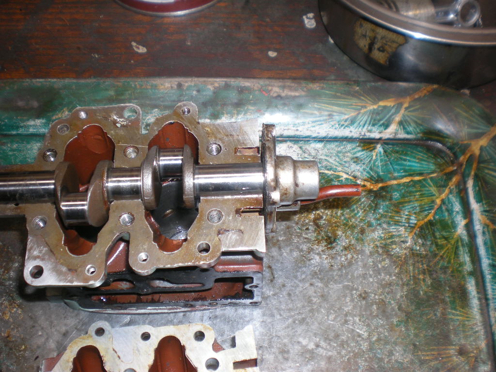

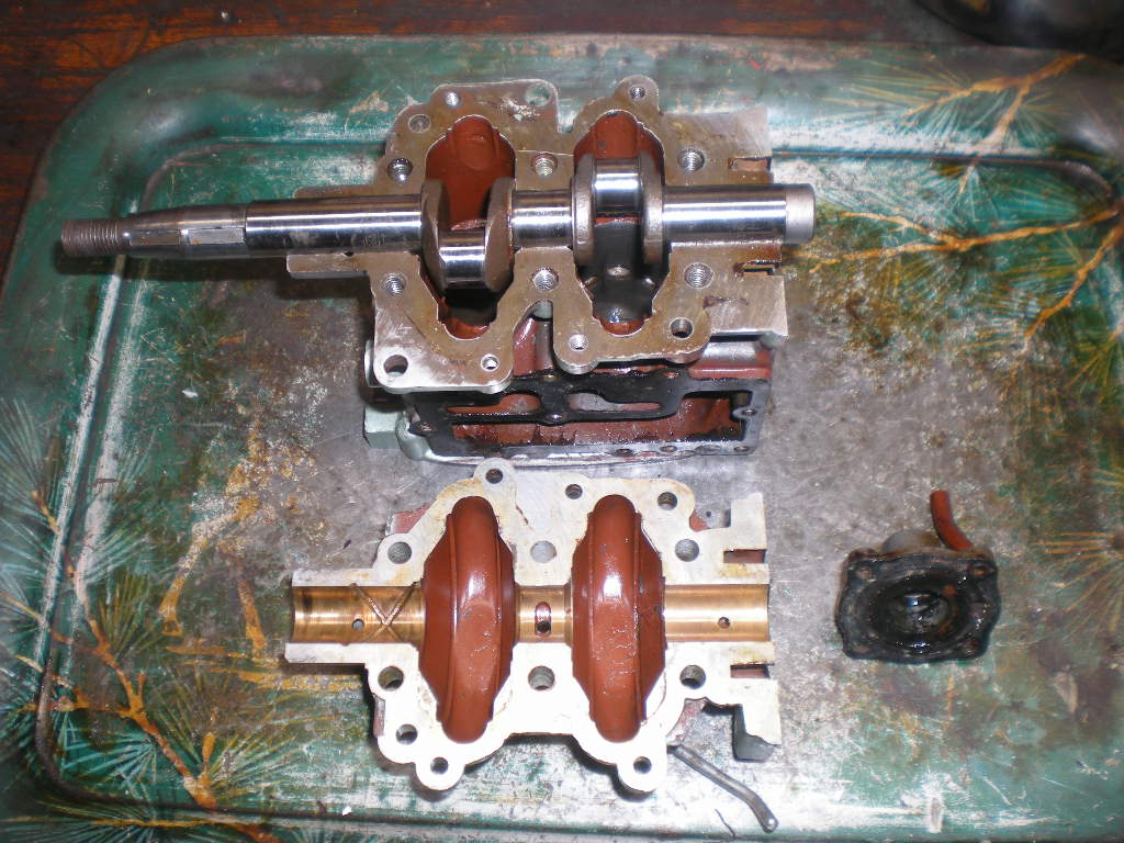

I pulled the front cover off the power head of the HS-20
(that’s stuck) this morning. More rust than I wanted to
see in the crankcase. Threw in in my bucket of acetone / ATF
for now. I have a parts HD that I may try to scavenge
parts to make one more running unit.
Anyone ever try, or go to the trouble of planning down the
crankcase halves and then line reaming the crank journals
to tighten up the crankshaft fit? Not sure if it would work
out, but just a thought!Prepare to be boarded!
April 3, 2017 at 8:21 pm #55464Not what your suggesting, and it might end up being a no no, with the knowledge I got in the machine shop. What I did in the bottom end of the crankcase was bor out a slot, and put a o-ring in to seal it up better for the crankshaft leaks. Works very good.
April 3, 2017 at 8:58 pm #55468Oltimer, could’t you bore out the top and bottom
of the crank case for a regular seal?
I have no milling machine, so probably beyond my
capability.
My "Parts" HD-25, which was loose, but had low
compression, had stuck rings. The crank in it looks
good, so I may throw something together using the
HS-20 and the "parts HD-25".Prepare to be boarded!
April 3, 2017 at 9:30 pm #55470It’s touch and go as far as material/metal available on the bottom end. Total material available: 1.146. Crankshaft at that fit: .685. When you subtract that portion from 1.146, sure does not make it easy to find that thin of a fit seal; but it "might be available"? Remember the seal has to have metal holding it to when doing the calculations? The oldtime friend of mine that owned a dealership and large shop is the one who recommended to o-ring the bottom; that’s why I took the easy way in doing it. He was telling me they did several like that, and it works very soundly.
April 4, 2017 at 12:06 am #55478Oltimer, are you talking about an O-ring installed in a groove
machined in the crankcase bottom journal, or in the
cap that bolts on the bottom of the crank case?
P.S.- those 1-3/8" diameter pistons sure are cute!
Thanks.P.S.- I measured the crankshaft "mains" at .680
on my veneer caliper, but maybe I need to go
digital……… those little lines are getting hard
to read!P.S.S. – I had a link to SKF where you could search for a
seal by part number or "inputted" desired size.
It’s not working anymore.
Anyone know of a similar web site?Prepare to be boarded!
April 4, 2017 at 6:10 am #55513In the bottom journal Buccaneer.
