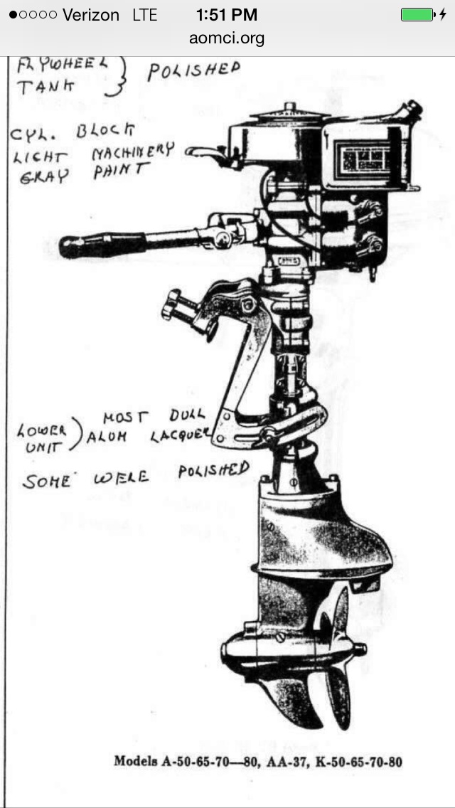

          This should be close
          #52541
            When aluminum started replacing cast iron and brass, the aluminum lower units were polished because the mercuric oxide used in the polish seemed to inhibit corrosion. . . 😉

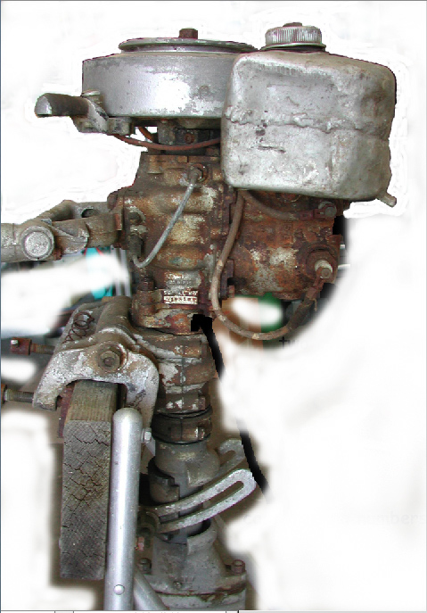

                Not even close. . . 🙄
                But I might stir up some interest. . . 😆

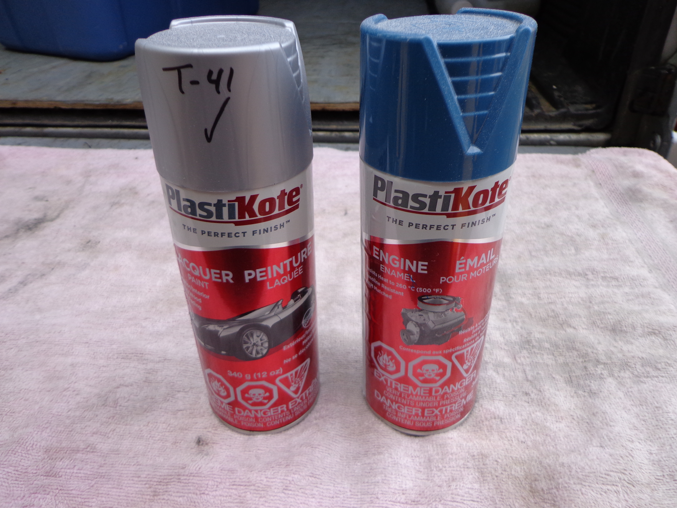

                  One last question and I will stop bugging. Do you know of the paint colors names or codes.

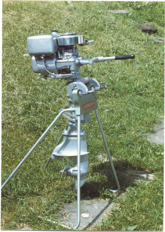

                    Here’s one. Mines not ready for a photo shoot yet.

                      quote pooks:

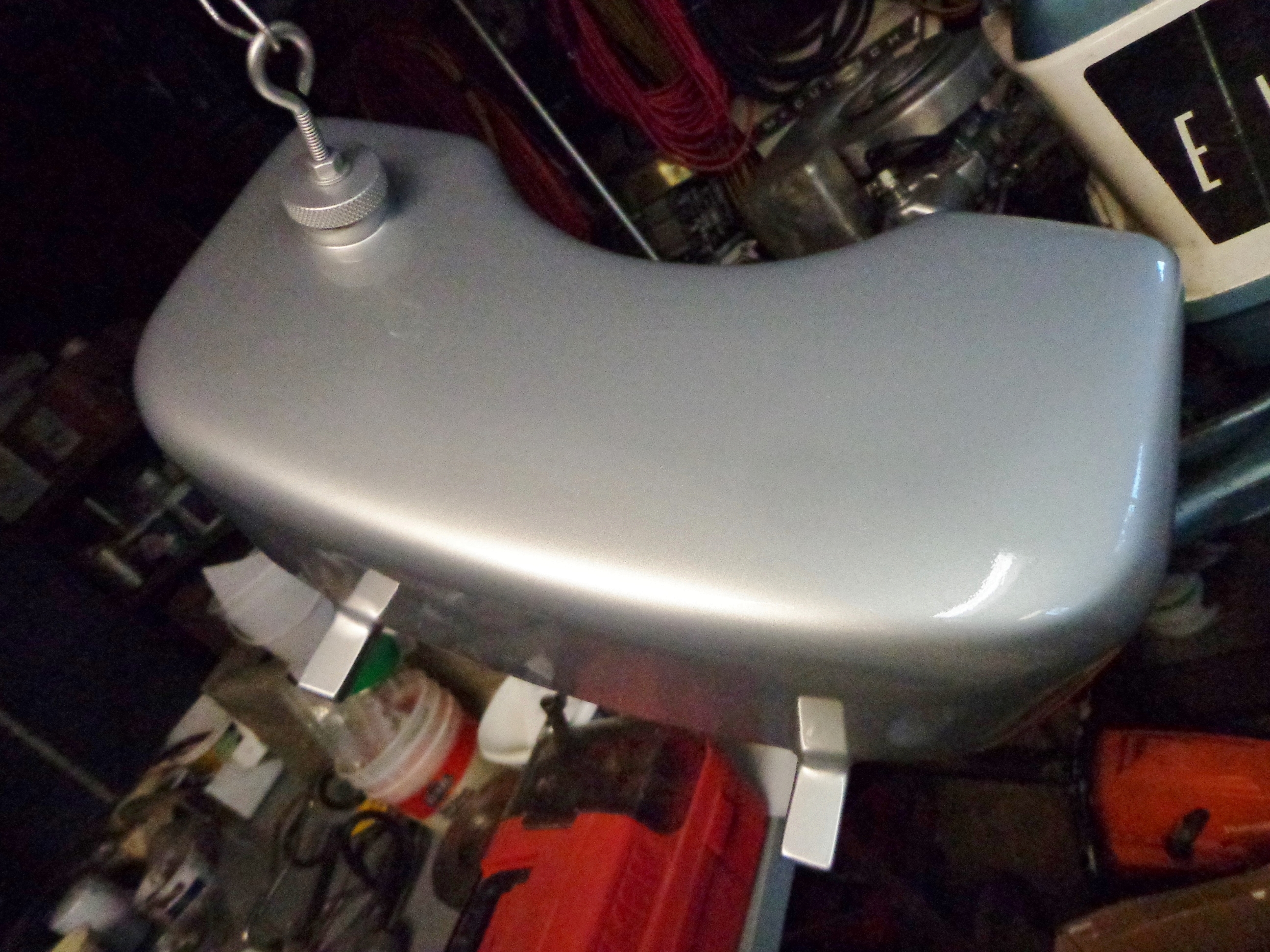

                      The tank on mine is painted with base/clear automotive paint. It’s a Ford color and might be Silver Frost. The gearcase, flywheel, and brass prop are polished while the rest of it is painted Dull Aluminum out of a rattle can. It’s not quite finished yet so I don’t have a photo of the complete motor.
