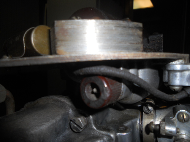

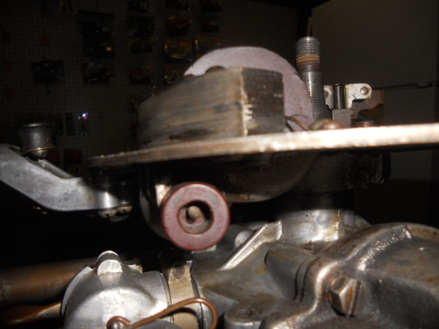

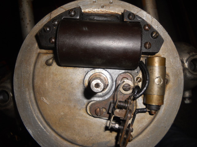

March 25, 2016 at 10:09 pm #33910Post a picture of the mag plate with a good view of the coil.
March 25, 2016 at 10:40 pm #33914Will do tomoro,left it at the shop and knocked off for the night.
March 26, 2016 at 10:27 pm #33956Took a pic of the mag plate and beneath the mag plate where I thought the plug wires screwed into the bakelite caps with studs in them. I was under the impression the wires just twisted into the caps onto the studs?
