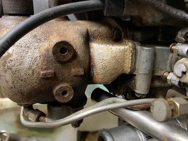

I have a pair of Johnson A’s I’m working on. One is 1922 and the other 1924. The earlier one has screws holding the steering bar to the cylinder heads.
The 1924 is missing the bar. Later motors (e.g. A-35) would have studs in the cylinder for the bar to set on and then secured with nuts.
I pulled these out of a junk jug thinking I’d use them like the later model but now I’m wondering what was “right?” Did they use screws originally, like my earlier motor? That’s why there are no studs in the 1924? When did they switch over?

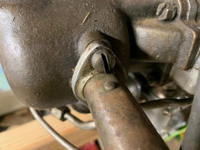

December 18, 2023 at 10:11 am #283316
I looked through my picture files and the screws
seem to be corrects for the A & A-25. Studs appear
on the A-35 going by the pictures I’ve saved.
There are a few exceptions but parts do get moved
around over the years.

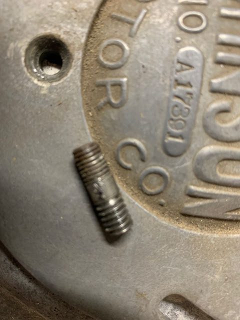

December 18, 2023 at 10:19 am #283317
After posting I looked at the motors I have had.
This A 25 looks to be original and it has studs.
December 18, 2023 at 11:04 am #283318
Here is something to add to the confusion.
December 18, 2023 at 11:56 am #283319Thanks for dipping into your library, Tubs. Helpful as always. : )
December 19, 2023 at 7:26 am #283340Johnson changed from screws to attach steering rails to studs and nuts beginning in early 1925. An early 1925 A-25 would have had screws but a later 1925 or 1926 A-25 would have had studs and nuts, however there would have been some overlap.Your 1924 A would have definitely had screws.
December 19, 2023 at 11:30 am #283346
The serial number of the motor I posted a picture of
was in the 42.000’s making it a 1926, inline with
Stanley’s verification.

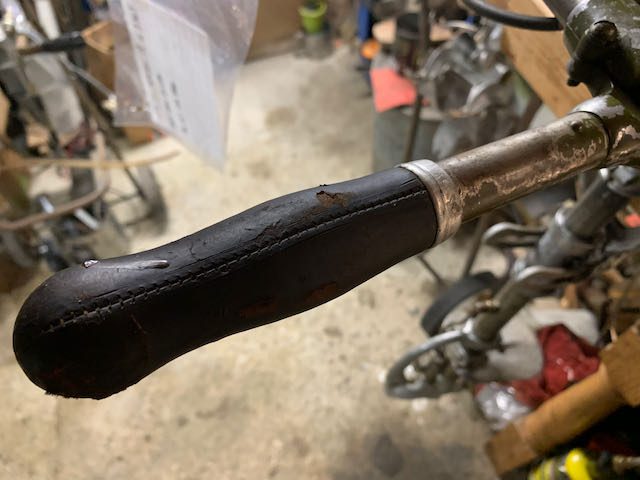

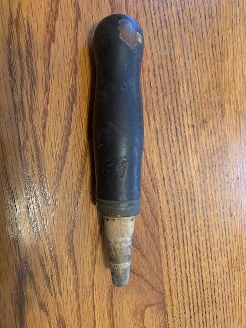

December 21, 2023 at 12:39 pm #283391December 21, 2023 at 1:06 pm #283393Anticipating your question,there is a 2 part (w/slotted screws) aluminum casting that clamps onto the steering rail.The tiller tube is attached by a large river to the casting.The tube and steering rail on all pre 1924 motors are plated steel.The 1924 model A both were plated brass and1925 A25 was also.1926 was plated brass steering rail and aluminum tiller tube.All came with leather/wood Bulldog grip.
December 21, 2023 at 4:43 pm #283395Stanley, you know so much about these early Johnsons! Thank you for sharing what you know.

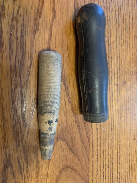

My 1922 has a nice leather grip
I picked up another leather grip at a swap meet. It has a wooden piece inside of it. I pulled the grip off the 1922. No wooden piece.
