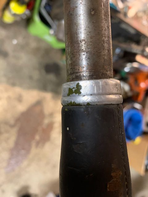

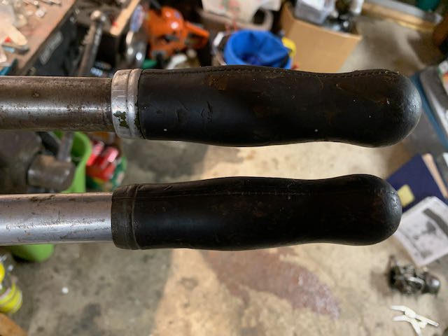

      The 1922 leather grip fits snugly on the tiller tube.  Would there have been a similar wooden pice inside the grip on the 1922, or is that for a later application?  Any thoughts on reproducing the aluminum ring that seems to snug the grip onto the tube, or just leave well enough alone?
      IMG_0639
      IMG_0637
      #283405
      stanley
