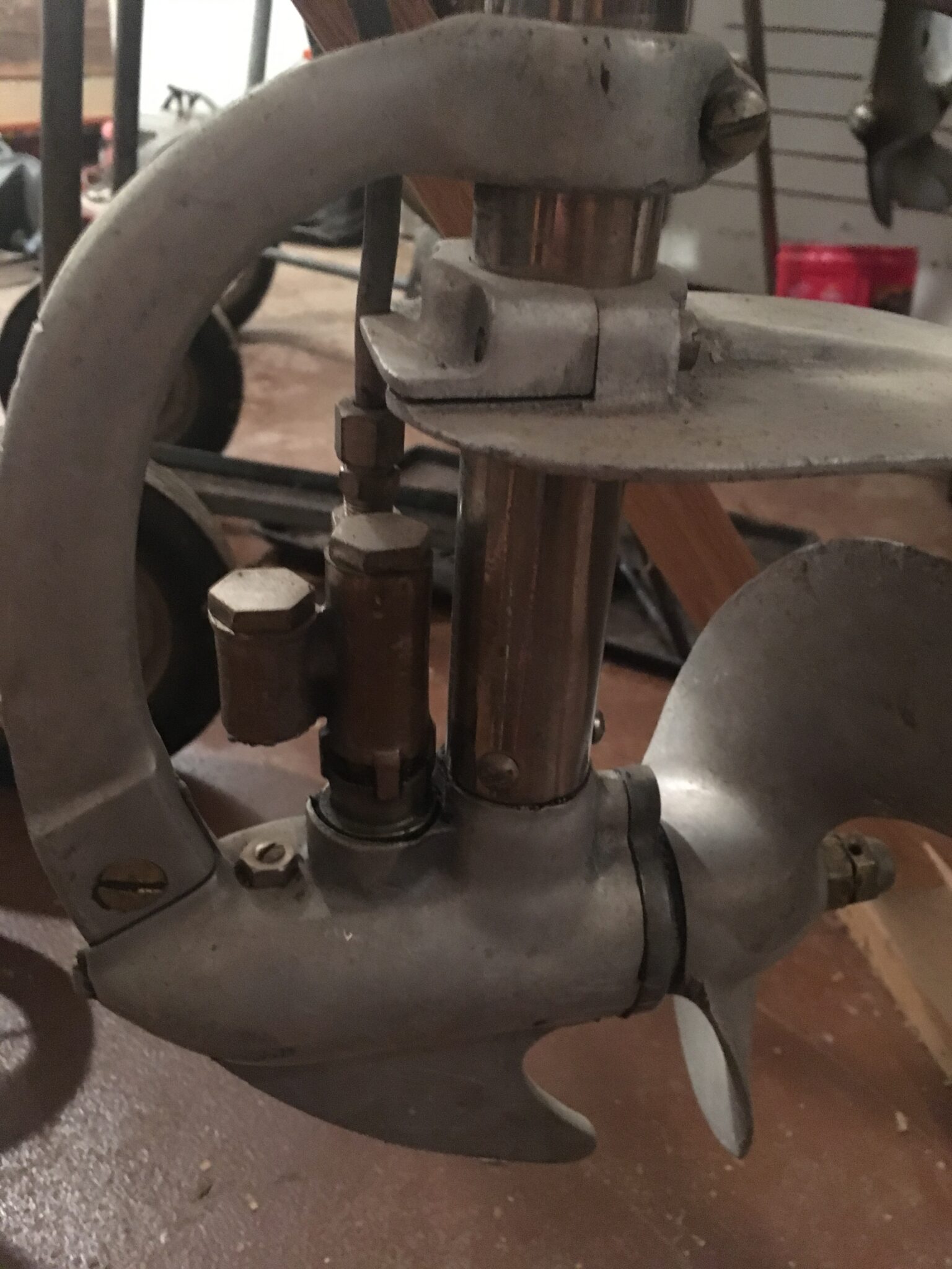

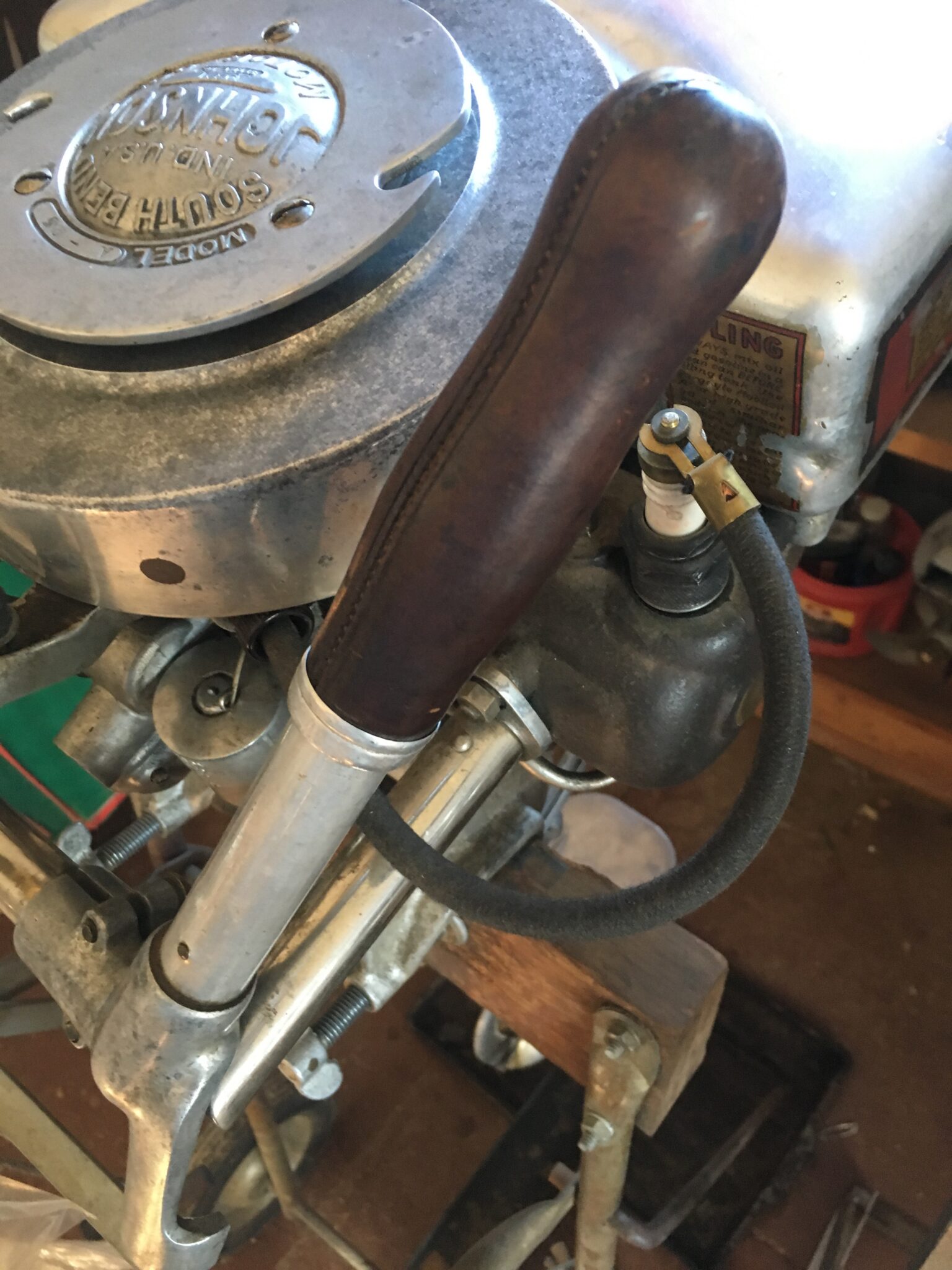

    stanley
      The original tiller grip would have been leather like all the A and A25 models had.The cavitation plate and support are of the A25 style rather than the usual A type.The waterpump is the 1925 A25 version.According to an article by Bob Zipps in January 1989 Antique Outboarder,the Johnson A models 1921-1926 included A,A25,AB25,ABC25,AC25,AS,B,BN,BNS,C,D,DN,E,and F.

          #251033
          davidk
            Thanks for the input, guys. Stanley, this pump and cavitation plate looks just like a Model A I’m working on. Got a photo of the differences you’re describing?

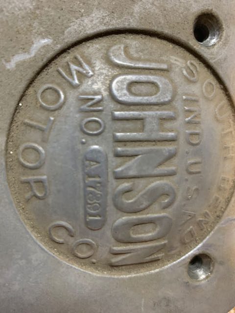

              #251042
              davidk
                I have a AC-25 myself with the standard transom bracket and a reproduction canoe bracket.
                Unfortunately regardless of the model in most cases if used in salt water
                Regularly the cylinders were not long for the world.
                Nice find, does the ser# on the rope plate match the crankcase number?
                Congrats on such a nice find!
                Respectfully,
                Yes, Brook, matching serial number.

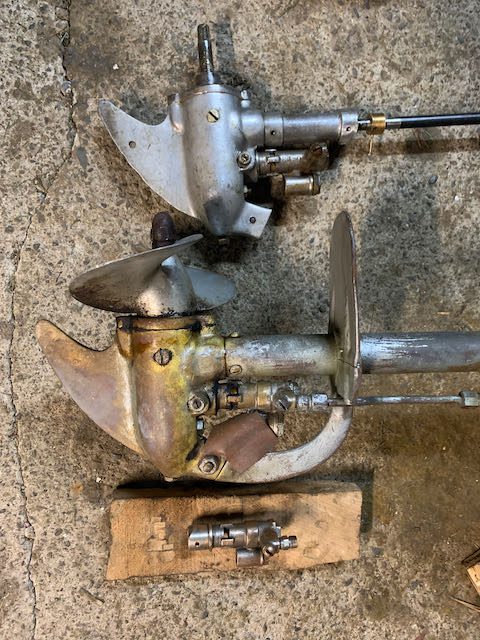

                #251047
                stanley
                  Here is a 1925 water pump and second one is 1926.The early a cav plate and longer support strut last.

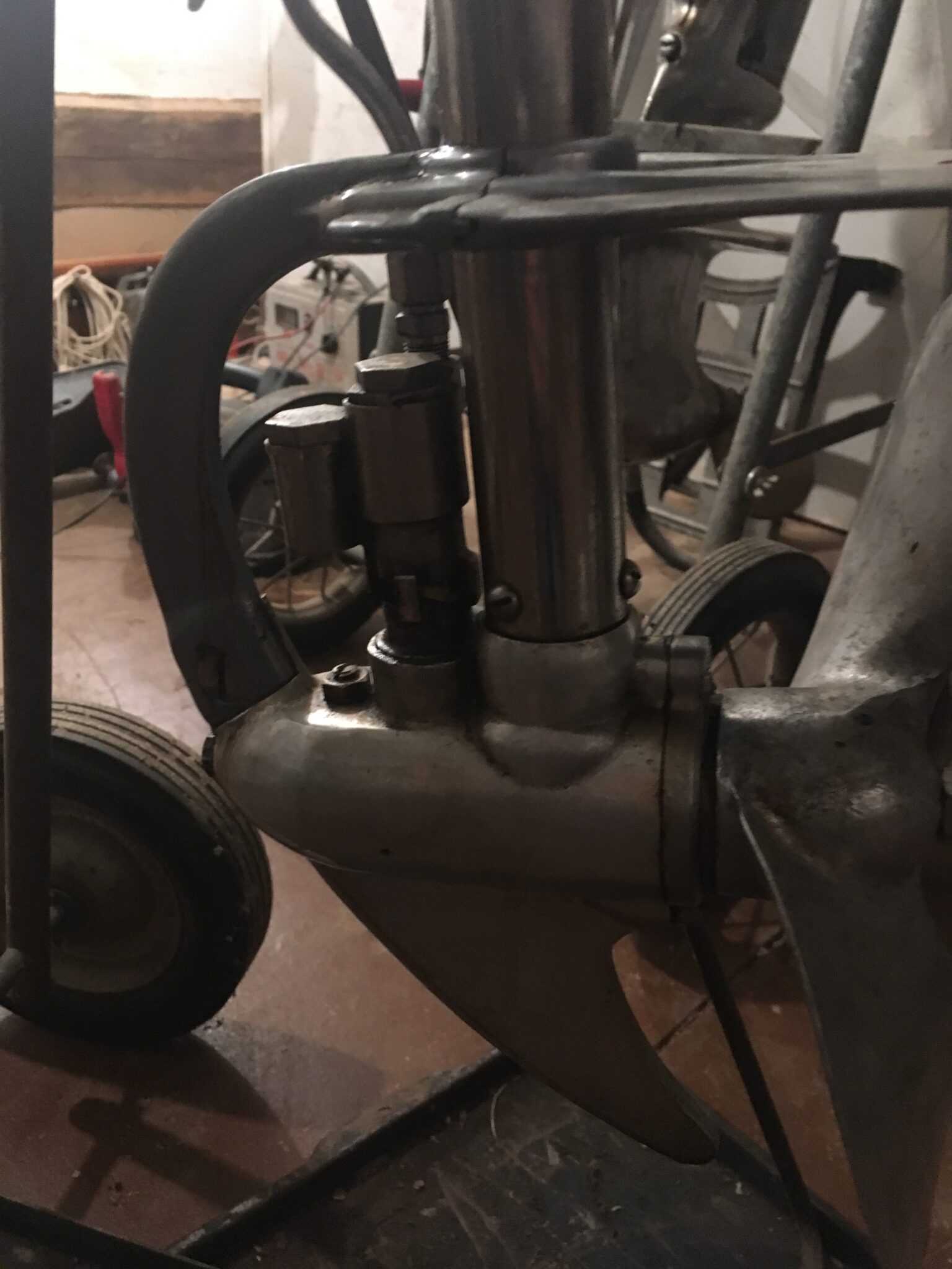

                  #251056
                  stanley
                    1924 pump an cav plate

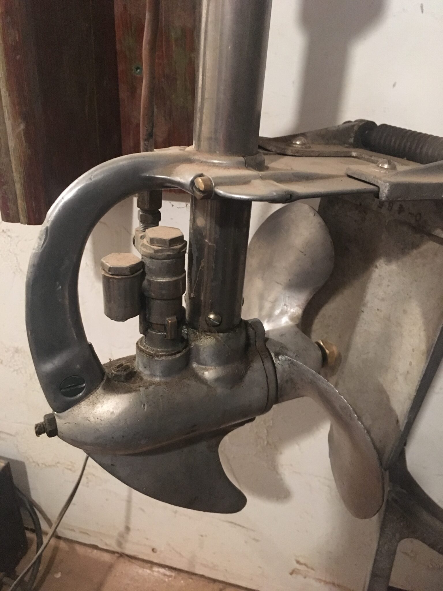

                    #251058
                    stanley
                      1925 pump and cav plate
                      683FB030-2B4F-4C00-BC95-C7C189C2C6C3
                      • This reply was modified 4 years, 2 months ago by Mumbles.
                      #251060
                      stanley
                        1926 pump
                        E76FB28E-2EAB-4F82-8BC1-BBF92427FAD4
