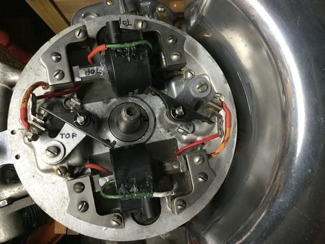

          squierka39
            I did omc coil swap to a K-80 Johnson, it’s alternate firing so only one coil per laminate but the space between heels and coil doesn’t seem to matter.
