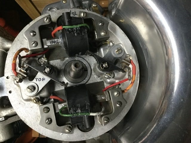

            squierka39
              #201786 Reply
              Ok, I’ll keep it simple and fit the military surplus one first and see how it runs. I’ll keep the omc coils for my K50
              Those work in the K mags too. Hers a set I put in a K80, same basic mag as the K-50. Condenser values are the same as the universal coils so if the old ones are good they will work. If not, just squeeze new ones in.
