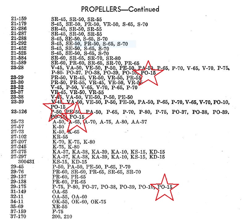

              #46261
                Going a bit deeper into the Johnson parts book, I found a few more listings for PO props.
                Confused yet? I am, as I don’t have any idea what diameter or pitch they are! 😕
