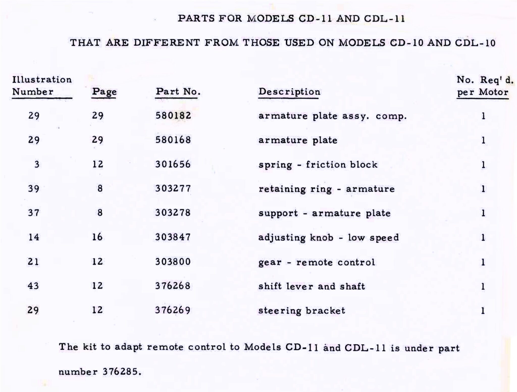

              1954-Johnson-5.5-parts-that-are-different
              Dave, I attached an Owner’s Manual for you and a link to a Parts Manual cuz it was too big to post here.

                Thanks for the information, Aquasonic! There are no gussets on the carry handle of my motor. Also, the shifter does not have a keyway, so my motor must be a Model CD-10.
                I was unable to download the information that you attached to your message. I am working from an iPad, so I’m not sure if the iPad knows where to file the document. Do you know whether I need to create an account with WeTransfer to be able to download documents?
                With the information you provided about the Model CD-10 not having the carry handle gussets and shifter keyway, I can now postulate how the manufacturer ended up double-stamping the ID tag. The manufacturer likely originally stamped the motor CD-11. They then realized their mistake and corrected the incorrect stamping with CD-10. Looking at the tag now… it looks like the dashed “strikeouts” were a part of the final stamp of CD-10.
