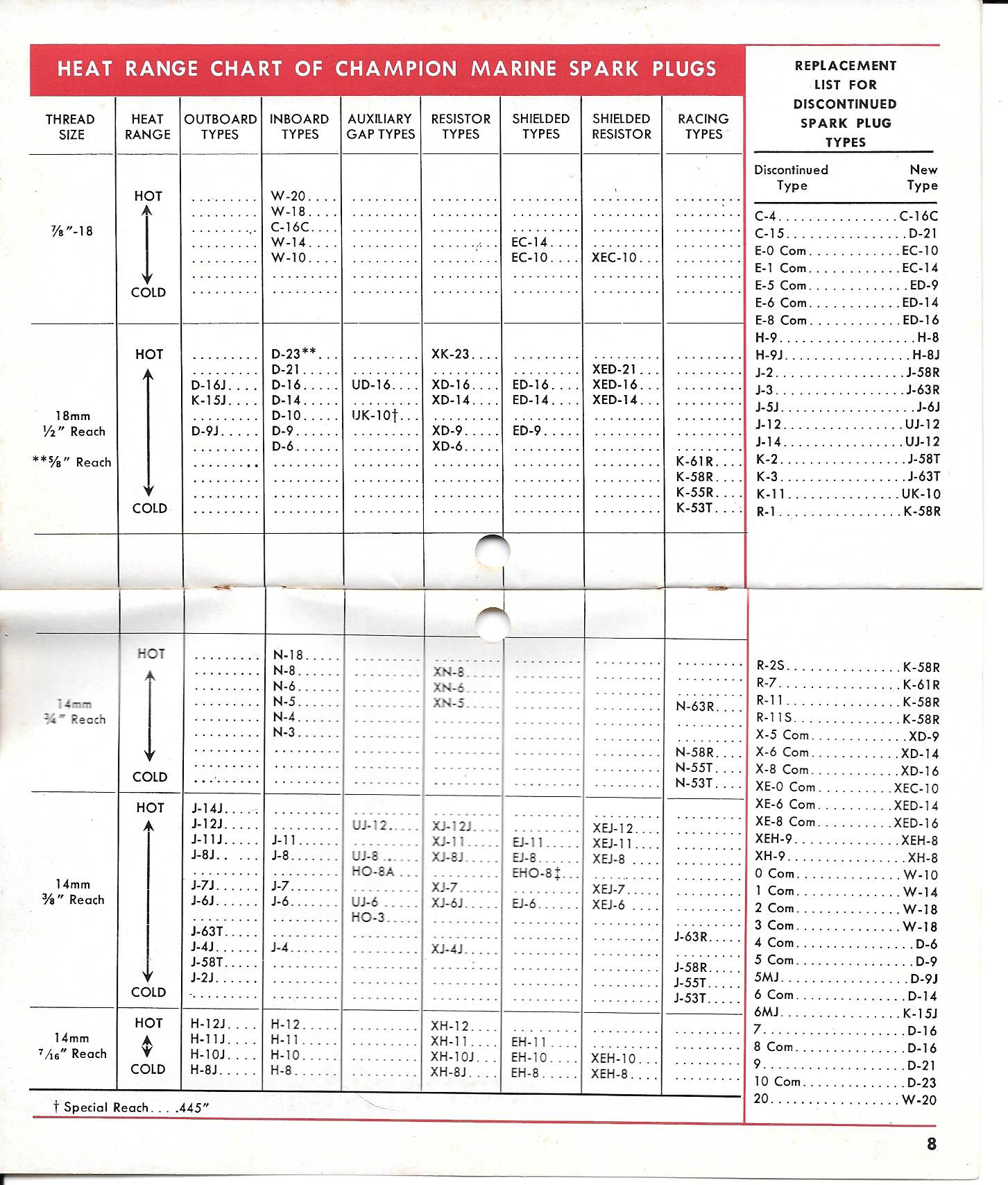

            MIKE SIMS
              I have a Champion Spark Plug Chart for 1965 showing replacement for R-7 to be a K-61R
              Champion
              #298790
                Your motor needs a 18mm plug with about 1/2″ reach. Examples would be Champion D-16 & D-17, AC-86. There are other brands as well.
